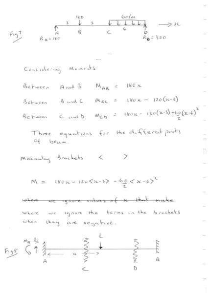

I'm trying to write a very simple program to generate shear and bending moment diagrams for beams.
The thing is that I don't know what kind of loading that the beam may see so I want to be able to write it as generically as possible.
I'm trying to find a web resource (not a book, unless it's an ebook or PDF) for the differential equations or for hints on how I can derive it from first principles. (I'm guessing that it has something to do with Newton's Second Law of Motion?)

Shear force and bending moment in prismatic beams are generally governed by ordinary differential equations, rather than PDEs. Try googling Euler-Bernoulli beam, or bending of beams.
In a nutshell: if y = deflection, theta = slope, M = moment, and V = shear, and the beam runs along the x-axis, then
dy/dx = theta
d(theta)/dx = M/EI, where E is Young's modulus, I = 2nd moment of area of the beam cross-section.
dM/dx = V
dV/dx = load on the beam.
Thanks.
There are no simple equations that hold for the length of a beam.
You either have to
1) Solve a set of ordinary differential equations, set up for different portions of the beam.
2) Use the impulse function, otherwise known as macaulay's method or macaulay's brackets.
The second programs well in a computer and does provide a single equation to work on.
Google will find plenty on this.

Yea...I started doing research into that, but from the looks of it; you might have to know some stuff about the possible loading conditions so that the singularity functions can be programmed in.
The thing is that I don't know what kind of loading conditions (on the beam) will be thrown at me, so the debate now is whether I want to go with the singularity function or effectively end up (accidently) writing a FEA code that might be discretized in both time and space.

The example I showed used specific figures.
Create a variable for each one and use symbolic calculation.
Standard cases might be point load, constantDL, triangularDL, parabolic DL and so on.
You have to do this to tell the program about the geometry in any case.
I also think you are being too ambitious if you think you can create a simple but all singing all dancing beam program.
You would effectively be coding up KleinLogel, Pilkey or Roark.

If you don't know what kind of loads the beam will have, then your code must include sections which handle each type of load. For most beam loadings, the following are generally encountered:
1. concentrated point load at a given location.
2. concentrated moment at a given location.
3. constant distributed load over a given portion of the beam.
4. distributed load with a linearly varying load distribution (triangular distribution).
Other types of loading (e.g., parabolic distribution, etc.) can be derived, but they are somewhat less common.
