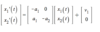

I have a quick question.
I have to write the differential equations in matrix form
Eq1:= x1'(t) = -a1*x1(t) + vf
Eq2:= x2'(t) = a1*x1(t) - a2*x2(t)
is this correct :
yes, it is
That looks OK, assuming "v1" and "vf" are the same thing.
yes v1 = vf and v2 = 0
