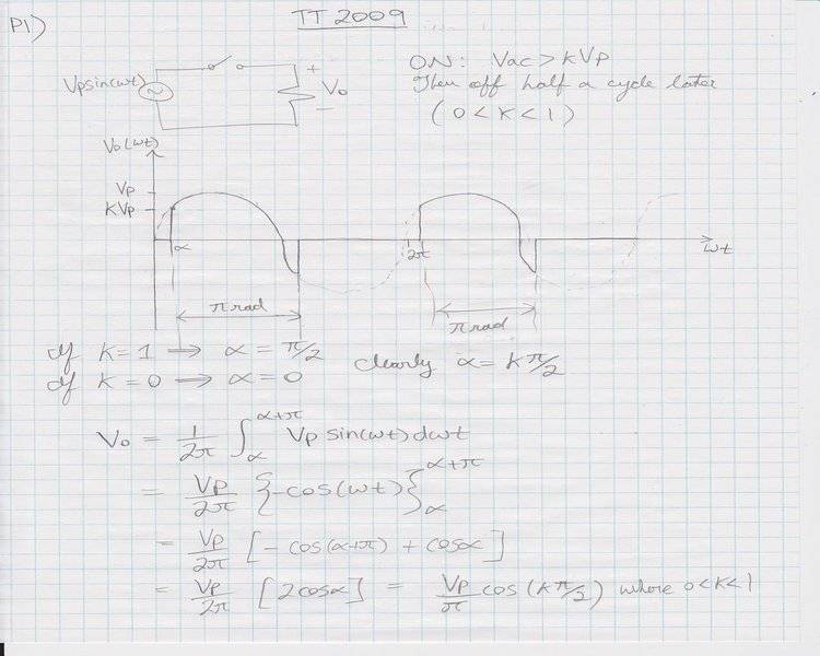

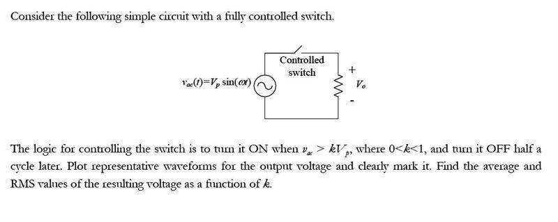

See figure attached.
See figure attached for attempt at the solution.
Can anyone verify whether or not my workings are correct?

You get a straight A - from me anyway!
BTW a quick way to get rms is to realize the power in a half-wave is half that of a full wave. You know the rms of a full wave is Vp/√2 so for the half-wave it must be 1/√2 of that, or Vp/2.
