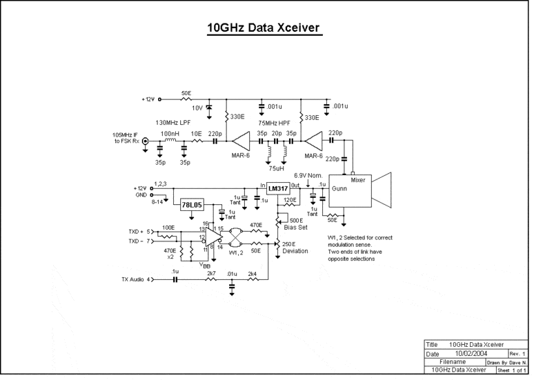

I use paintbrush and have done so for some 15 years
here's an example...
one of 100's of circuits I have done
is that crisp enough for you ? ;)
