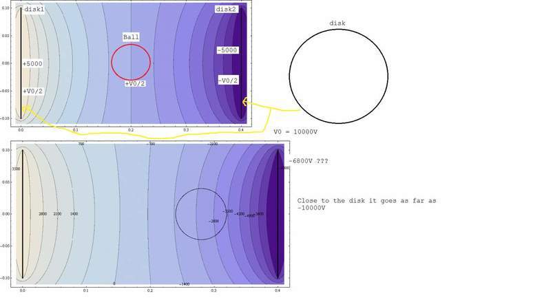

Hi,
how to calculate the force on a charged conductive body (ball), when that body is between two parallel plates (+V, -V) (see image), ooh and I am calculating numerically. I would first calculate the surface charges on the conductive surfaces (2 disks + ball), then calculate the potential field from the two disks ONLY (with those surface charge configurations, where the charged ball also had a say), and from this field, go on to calculate E=-∇V. I think the ball can't exert the force on itself (kinda like trying to pick yourself up while standing in a basket and pulling up on the handles), that is why I think you would only need to calculate the field from the disks, and then with this field E, calculate the force on the body F=∫dQ*E. Would you agree, or am I missing something.
I get strange values of equipotential lines in the contour plot (see image).
PS: One more question, if you charge a ball to a potential +V (touch on of the disks) and then move the ball away from that disk (no longer touching) towards the second disk, would the potential of the ball change on its way??

Hello juvan,
your ideas are correct, only the electric field due to plates is necessary. However, in order to calculate the charges, you will most probably need to find the potential first. This you can find from Poisson's equation, with boundary conditions on the plates and the object between them.
The equipotential planes should reflect the presence of the conducting body between the plates - they should be spheres surrounding the conducting ball.

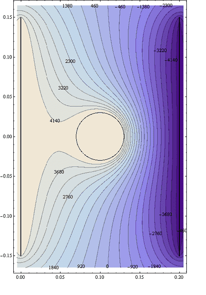

Thank you Jano, for your reply. Now let me further elaborate what I did. I started all the work from the solution of Poisson's equation for the electric potential [itex]V(T)=\frac{1}{4\pi\epsilon_0}\int\limits_A \frac{\sigma(T')da'}{R}[/itex] then I went on to copy some of the "magic" from the book, to set up the equations, and then with that set up I used the MoM to solve the integral equation for the surface charge density on the conductors [itex]\sigma[/itex], where I used - to generate all the equations for all the unknowns - the known potentials on the conducting surfaces (2 disks+ball). So now with the surface charge distributions known, I could easily go back to calculate the electric potential, and I got (see attached image). BUT I think that something is not completely correct so far, I have a hunch that I can't just say that the potential of the ball in the field is equal to some constant value (the value she got when she touched one of the disks).
Just to once more for clarity tell what my job is, I have to calculate the electric force exerted on the ball in between two charged parallel disks.

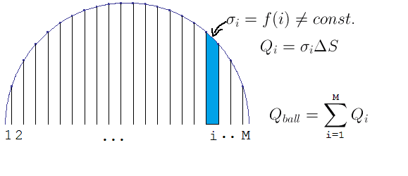

Back again. Ok this time I'll take an overall view of the problem to try to explain as best as I can where I get stuck. Let's word the problem again. Bare with me x)
There are two identical charged disks distance [itex]d[/itex] apart. Calculate the force exerted on a conductive ball, when it is put between these two disks, for simplicity let's asume we start by placing it so it is touching the left disk.
So we have come some way, but we (I) are stuck at the problem, what to do when we move the now charged ball, away from the disk. Let me guide you through my tought process so you can hopefuly see where I get stuck:
I CAN calculate all the σ (with the equation we set up in previous posts) on all the surfaces (ball(M) + disks (2N)) WHEN I know ALL (2N+M) the potentials. So that's why I start with the ball touching. BUT now as I move the ball away I am left with only 2N (N on one disk) known potentials, and 2N+M (M on ball) unknowns (all the σ's), without the know potentials on every slice on the ball (all the σ that go from 2N+1 to M) I don't know how to get all the σ. And I think I have to have all the σ to be able to calculate the net force on the ball.
So the big question is where do we get the M equations needed to uniquely solve for all [itex]\sigma[/itex].
Now.. the one information I sense has value is the TOTAL [itex]Q_{ball}[/itex] charge on the ball, which we took with us, when leaving the plate. But this is still not a lot of information to go on, at least I can't see it. I hope you understand where I'm still stuck.
If you can read Mathematica code, I would be happy to provide it... perhaps, if it helps.
The upper case of the words may be overkill, but I just like to emphasize it for clarity.
I attached a picture, just for some added clarity.

Hi again, this time I think I've got it. So to end this thread properly I'll just quickly tell what I did.
I think that I basically did what you said, it's just that I didn't exactly understand it from the equations and things you said.
This is the main equation I was starting from
[itex]k\sum_{i=1}^{M}\frac{\sigma_i \delta a_i}{R_{ij}}=V_{body}-V_0(T)\hspace{0.3cm};j=1,2,...,M[/itex]
[itex]k\sum_{i=1}^{M}\frac{\sigma_i \delta a_i}{R_{ij}}=\sum_{i=1}^{M}\sigma_i \alpha_{ik}[/itex]
But the thing to note is that the right hand side has Vbody and V0, Vbody is the potential of the body, and V0 is the potential of the external field, in this case, from the 2 disks. So this comes out to M equations BUT there is M+1 unknowns M [itex]\sigma_i[/itex] and one [itex]V_{body}[/itex]. And because we know the total charge on the ball we can use this as the last equation, [itex]\sum_{i=1}^{M}\sigma_i \delta a_i = Q_{ball}[/itex] giving us the final equation to properly solve for all the unknowns like this
[itex]\begin{bmatrix}<br /> \alpha_{11} & \alpha_{12} & \cdots & \alpha_{1M} & -1\\ <br /> \alpha_{21} & \alpha_{22} & \cdots & \alpha_{2M} & -1\\ <br /> \vdots & \vdots & \ddots & \vdots & \vdots\\ <br /> \alpha_{M1} & \alpha_{M2} & \cdots & \alpha_{MM} & -1\\ <br /> \delta a_1 & \delta a_2 & \cdots & \delta a_M & 0<br /> \end{bmatrix}<br /> \begin{bmatrix}<br /> \sigma_1\\ <br /> \sigma_2\\ <br /> \vdots\\ <br /> \sigma_M\\ <br /> V_{body}<br /> \end{bmatrix}<br /> =<br /> \begin{bmatrix}<br /> -V_0(T_1)\\ <br /> -V_0(T_2)\\ <br /> \vdots\\ <br /> -V_0(T_M)\\ <br /> Q_{body}<br /> \end{bmatrix}[/itex]
Which is nicely solvable. So this is it. Now I can finally proceed.
I can also see now, that we actually don't or I should say, wouldn't need the potential Vball to calculate the force.
Thank you Jano, for all your help.
