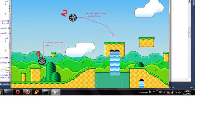

1. There is a Rectangle (shape could change), and a force like F, that effect the rectangle at point P on its surface. i don't know how the shape will move after impulse, the center of mass is CM, the center of rotation is CR, the shape mass is m.
I'm really sorry to ask a question like this! but I'm a software developer and these are all i got. the problem is building a simulator for shape movement.
2. T = Iα, T = F × (P - CR) then α= F × (P - CR) / I
angular velocity = ?
Inertia = m * R^2 // the R is the shape radius or it depend to the CR? and is constant or not?
Linear Accelerate = F.(P - CR) / m // I'm not sure!
liner velocity is simply calculate if the above sentence was correct.
angular velocity and the angle from CR is unknown to me?
thanks for your answer, it will be really helpful to me.

the shape is not fixed. when i hold the shape by mouse and move it side to side, the shape has a center of rotation as CR, am i right? when i release it, shape will rotate around its CM, but how to?
on that time calculation of the linear accelerate and Torque is not clear to me.
i even don't know how to use momentum to simulate the shape move!
until now by using only force i simulate gravity and so many kinematic formula. i have a circle that falls completely the same as what happen in the earth. but nothing else when its collide to the Earth just stop moving.
please give me some formula, anything that help me to solve this problem, thanks.
I add this to my code: θ = ωt + 1/2 α t^2 and rotate the shape by time. but ω, Inertia even the Torque and linear accelerate are still missing!
and this :
ω = ω + α t
there is a sample. until now.
You have a forced rotation around some arbitrary point before?
You can calculate the total momentum (just use the velocity of the CM point) and angular momentum (you can use the angular velocity around CR) of the object at the time of release, and use those to calculate propagation afterwards.
If the collision is elastic, it will invert its vertical velocity (or the component vertical to the surface, if the surface is not horizontal).
