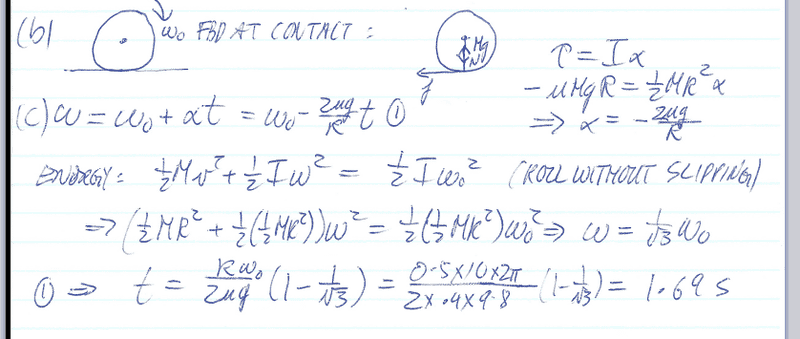

Here is a solution I found:
However, why don't they account for energy lost due to friction?
Everything in your solution was correct except the direction of the friction force. As the cylinder spins clockwise and slips on the surface, it scrapes against the surface and tries to push the surface to the left. So, the surface pushes on the cylinder to the right (+ direction). That force to the right on the cylinder produces a counterclockwise torque (your - direction). So, you had the sign of the torque correct. It is just the direction of ##f## in ##F = ma## that you need to correct.
Right. That solution is bogus. They also have the friction on the cylinder pointing in the wrong direction as well as not taking into account heat produced by friction. Note that if the direction of the friction is as shown, then the cylinder would increase it's rate of spin!

Anyway that makes perfect sense guys, thanks a lot!
So, what do you get for the answer now? It's Rω0/(3gμk), right?
Yes that's right
