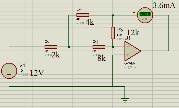

Can anyone help me how to find the current 3.6mA analytically?
I have tried but I didn't get any right answer.

Notice that the junction of R1 and R3 connect to the (-) input of the op-amp. What does that tell you about the currents through R3 and R1?
Now suppose that the op-amp is pulling some current I from the top node. Where can that current come from? Doesn't it all end up coming from the 12V supply? So if you did happen to know what I is, could you write an expression for the voltage at the (-) terminal?

Let v2 = voltage at R1/R2/R4 junction.
Taking advantage of knowledge of the voltage at the - input,
G2(v2 - Vo) + Io = G3*Vo where in general Gi = 1/Ri, i = 1,2,3 or 4 and Io = current out of op amp.

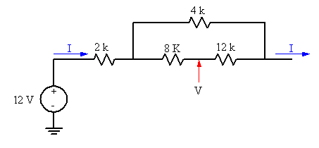

If you assume that current I is being sunk by the op-amp, it can only come from the 12V voltage source. That gives you one series resistor and a parallel section. You know what the voltage has to be where the op-amp connects in the chain, indicated "V" in the diagram:
You can use the current divider rule to find the portion of I which passes though the 8k resistor, and taking a KVL walk from the battery to the point marked V has a known potential drop. Solve for I.

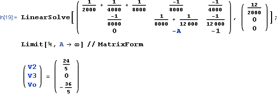

The first method would be to perform a source transformation on the 12 volt source and R4. They are replaced with a current source of value 12/2000 in parallel with a 2000 ohm resistor, and we don't deal with the V1 node directly. Instead of a KCL equation at the Vo node, we use a constraint equation. Let the opamp have a finite gain of A. Then the constraint equation is Vo=-A*V3. In the solution take the limit as A -> ∞ to account for an ideal opamp . This solution in matrix form looks like this:

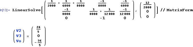

The second method is to divide the constraint equation through by A, giving a new constraint equation -V3=0. Now we get a solution that doesn't involve A, and we don't have to take a limit to get a final solution for an ideal opamp:

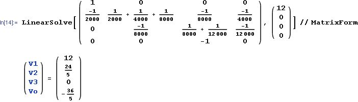

The third method includes V1 explicitly and adds another constraint equation V1=12. The solution for all 4 nodes now includes the result V1=12, which we already knww:
And, of course, the current the OP asked for is simply the sum of the currents through R2 and R3, which are easily calculated since we know the voltages across each of them, or it's the current through R4.
