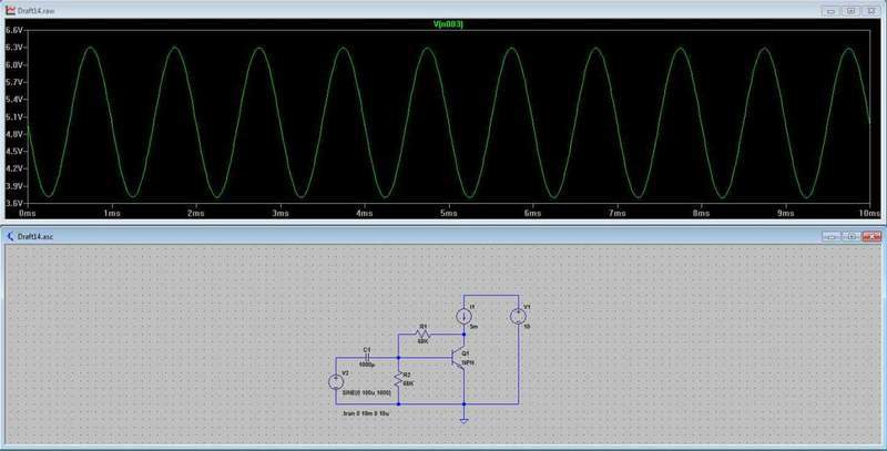

The attachment shows some values that worked for me. Note that the signal must pass through the 10K resistor. That tremendously reduces your gain. The usual way is to couple the signal in through a capacitor.
In the first plot, with a peak input voltage of 1mV the circuit has an unloaded output of 3.3mV or a voltage gain of 3.3.
In the second plot, with the peak input voltage reduced from 1mV to 0.5mV the unloaded peak output voltage is about 1.25V for a voltage gain of 2,500.
Of course you won't be able to realize that gain once you load the output but this gives you and idea of how a simple change to the topography can significantly change the result.

fobos3 said:
Vin is a 1mV sine wave with no offset, V is 10V, and the R1 and R2 resistor are in the kOhm range. I change their ratio to set up the gain.
The problem I am having is that the output is given by:
[tex]V_{out} = V_{be}-\frac{R_1}{R_2}(V_{in} - V_{be})[/tex]
So, if I set the gain to 1 or 2 my sine wave at the output has an offset of 1.4V and 2.1V respectively. Eventually this offset reaches the positive power rail and I get a DC output. This is for R1 = 10k, 20k and R2 = 10k. The gain between the input at the base of the transistor and the output is 71dB.
Can you AC couple the output of the amplifier to the load (load impedance unspecified?)?
I see what you've done. Indeed, I have tried that and my problem is the offset at the output that is also present in your simulation. Maybe there is no way to remove it and I'll need to add a differential stage.

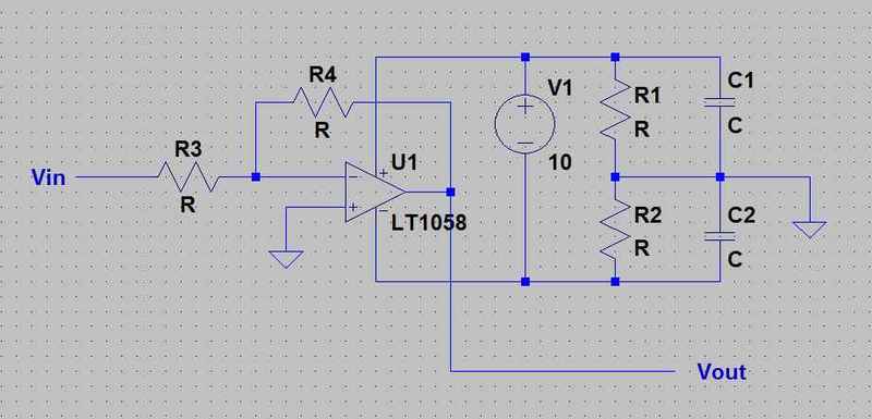

The only realistic way to accomplish what you want to do is with an opamp and a dual power supply.
R1 & R2 along with C1 & C2 create an artificial ground. R1 & R2 should be equal to each other as well as C1 & C2. The lower the values of R1 & R2 and the higher the values of C1 & C2, the better the ground will be, but of course as you lower the values of R1 & R2, the more power your circuit will draw. The gain of your circuit is determined by the ratio of R4 to R3. This circuit will give you an inverted output, i.e. negative gain. If you need positive gain this circuit can be modified for positive gain.
Yeah, I thought so. Thanks for your help.
except that you will struggle to find readily available ( if any) Op-Amps that will work over a few 10's of MHz
