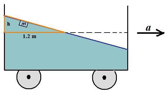

I don't think 120 cm is the right answer. Sounds like you generally have the right approach. Using half the length of the tank for the base of your triangle sounds good. Could you explain in more detail how you arrived at the angle for the triangle?
I used components method. I took the inverse tangent of 0.5 (ratio of 4.9/9.8) to get 26.6 degrees or so. Using this angle I couldn't get any of the listed answers, so I used the complementary angle of 63.4. This allowed me to find the opposite side of the triangle (height) which was 2.4m. Subtracting by 1.2m the original height, I got 120cm. This was the only way I could reproduce one of the possible answers.
When I use tan26.6 x 1.2 I get 0.6m. Is that correct? I discarded the answer because it's lower than the original height of the water, but maybe the base of the triangle is at the surface of the water?
Let the angle to the vertical of the net force from the truck on the water be theta. What do you get for tan theta? How are you then calculating h from this? Your method looks right, but you have not posted enough detail to say where your error is.

Doesn't it look something like this? Isn't 60 cm for h ok?

Ahh that makes so much more sense. I was originally drawing the triangle from the base of the tank. The height of the triangle is the additional height that the water moves. Thanks so much!
