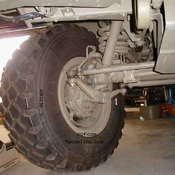

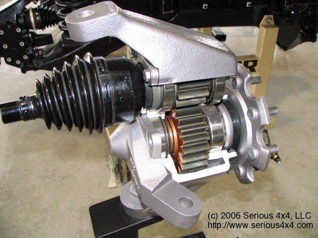

That being said, a very few 4x4 vehicles do have gearsets at the wheels (known as portal axles) to help reduce driveline forces and increase ground clearance to the axle shaft- Hummer H1's and Unimogs for example:
Hummer portal axle cutaway:
Unimog portal axle:
