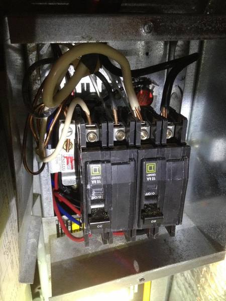

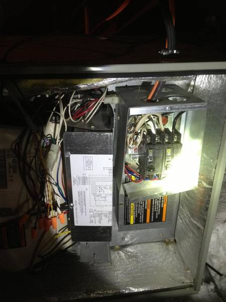

This is what I am working with:
well that looks to me like single phase 240 volt.
Find the transformer, it'll look like those in the Grainger link and that youtube video.
Read its nameplate and check its output voltage..
If it is making 24 volts and you have 28 at thermostat, something elase is wrong.

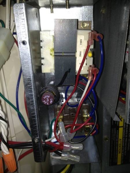

I looks like I possibly have two of them? Also noticed that the top one says 230v.
top looks like a transformer, bottom like a relay.
Now you need to see whether it's producing 24 or 28 volts.
Also - housepower is nominal 240 but can run 253 here in US .
253/230 X 24 = 26.4 , so your transformer would be within its rights to deliver 26.4 volts if your electric company's voltage is at its high limit that day. Maybe even a little more if it is lightly loaded...
Can you safely read incoming voltage and transformer output within a short time, like a minute ?
It might be that you need a 240 volt transformer.

Incoming voltage is 246-247.
Output is 27.8 which is the same at the thermostat.
So I am thinking that I do need a different transformer (240) to get the the output closer to 24. Your recommendations? Thanks for all of your help.
Well in an ideal world, a 230 to 24 volt transformer with 247 on its input would put out 25.78 volts.
You are getting two volts more, almost 8% more, which suggests your transformer is lightly loaded.
Before picking one i'd want to know its load.
You should be safe if you get one rated and marked for 240 input.
If you can't determine load on it, pick one that weighs no more and not a lot less, maybe 2/3.
Feel the one that's in there - it should be pretty warm with that much voltage on it.
A 240 volt one should run noticeably cooler.
