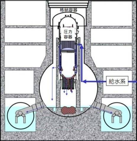

Have the TEPCO workers found the precise location of the melted fuel at the affected Fukushima NPP nuclear reactors? If not, have they at least hypothesized where it might be?
Cameras have been inserted into the reactor pressure vessel, but the footage hasn't revealed very much in terms of the integrity and location of the core...
Has it been concluded whether or not the cores burned through the steel and concrete base of the reactor building and into the Earth in a "melt-through?"
No, they have not. Cameras have been inserted into the PCVs alone (and not all the PCVs at that) with less than enlightening results.

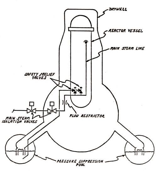

Astronuc said:
The video was uploaded on Jan 20, 2012 according to that page, so it is very old. Note the white noise in the video. This is attributed to the high radiation levels in the vicinity of the CCD in the camera.
Have they inserted a camera into the reactor pressure vessel itself yet?
Not yet in the RPV, or underneath it (I'm assuming that if Tepco has, they would share that information). It will be a BIG story when Tepco finally looks at the damaged core and fuel.
As far as I know, they have lowered cameras to the torus of one or more units.

Kutt said:
Have they concluded whether or not the cores have burned their way through the concrete base of the reactor building and into the Earth beneath it?
Thankfully, concrete base is about 10 meters thick.
Models so far say that corium almost reached the containment bottom (the light-bulb shaped thing), and if they are wrong, it may indeed reached it, but there are 7.5 more meters of concrete below it.
