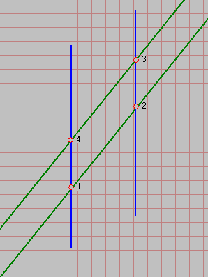

These diagrams show how the simultaneity is different when events are seen from three frames. I'm not sure if the labelling corresponds to yours.
