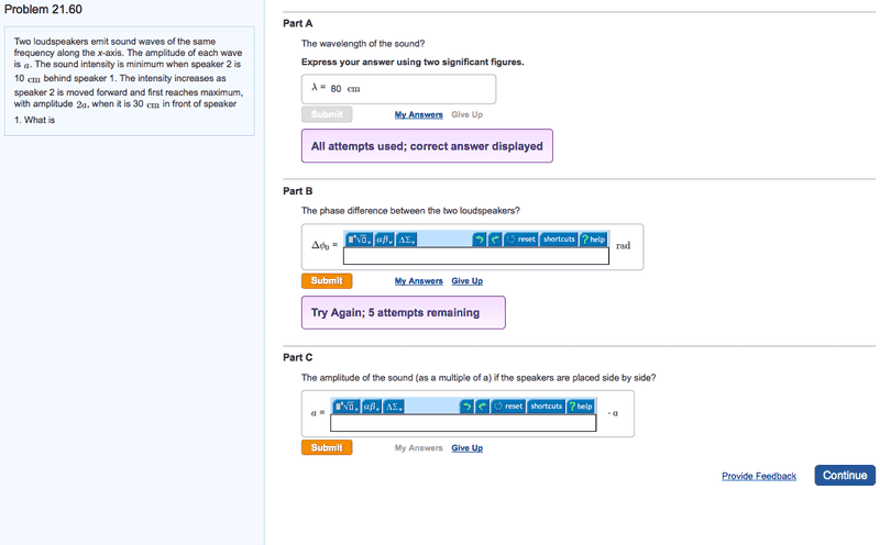

See attached image
Δphi = 2pi(Δx/λ) + Δphi0 = 2pi(m) -- at the maximum
Δphi = (m + .5) (2pi) -- at the minimum
The first step should be to solve for lambda, the wavelength.
So I plug in the knowns:
At 30 cm the amplitude is a maximum, so:
Δphi = 2pi(30/λ) + Δphi0 = 2pi(m)
I am not sure what to do next. I tried too many times, so it now displays the answer as λ = 80 cm, but I'm not sure why that is true. I need help on the rest.
I'm just not sure what to do since I am missing more than one variable.

You can figure out the wavelength by inspection: while the speaker moves 40 cm the wave goes from a minimum to a maximum. That tells you that 40 cm is what fraction of the wavelength?

λ = 80 cm, since 40 cm = (1/2)λ.
The equation for the output of speaker 2 at x = 0 would be:
S2 = a*cos(-ψ)
The equation for the the combined output would be:
S1 + S2 = a*cos(-ψ2 + ψ1)
k = 2π/80 = 0.0785
So at x = -10 cm,
S2 = a*cos(0.0785*(-10) + ψ2).
I'm not sure what to do from here, though.

Think about the information you are given. You now know the wavelength, and you know about how far apart the speakers are when the total output is at a maximum (that is, when the speakers are in phase). From that you can figure out the phase shift.
Or you can use the equation cos(kx - wt - psi) for spkr 2 in terms of the two speaker locations to find psi (and lamba).
In other words, cos(kx' - wt - psi) for spkr 2 in front of spkr 1, and cos(kx'' - wt - psi) for spkr 2 behind spkr 1.
With x' and x'' as I previously explained.
Just to clarify, I have diagnosed myself Physics-retarded. I'm not bad at many other things, but Physics sometimes baffles me.
So from this, I see that I might be able to use the equation I provided originally:
Distance they are apart at a maximum = ΔPhi = 40
= 2π*(30 cm/80 cm) + ψ
40 = 2.35 + ψ
ψ = 37.65
Correct?

I think my problem is that delta phi, the distance they are apart needs to be in radians. How could I find that value?
37.5 deg = 37.5/180 * pi radians. (But I didn't get that. Waiting for tms to reply ...).
My thinking is that the speakers are in phase when they are separated by 3/8 of a cycle, so the phase difference is [itex]3\pi/4[/itex] (or maybe [itex]-\pi/4[/itex]; I always mix up the signs).
Thanks, it was 3[itex]\pi[/itex]/4.
So to find the value of a,
3π/4 = a*cos(40k + 3[itex]\pi/4[/itex])
and solve for a, correct?

If you placed them side-by-side, the two signals would add up to
a cos(kx - wt) + a cos(kx - wt - ψ)
where you can arbitrarily pick x = t = 0 so the addition reduces to
a + a cos(-ψ).
So in order to find the amplitude, I would isolate a, correct?
I still don't know what you mean.
a is given to you. It's the amplitude of each speaker by itself.
Putting them side-by-side gets you the net amplitude of the two outputs. So if that amplitude is called a', then a' = a + a cos(-ψ).
