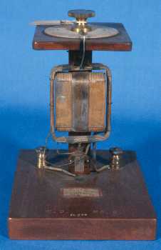

A vintage way:
An electrodynamometer is an instrument used for measuring the electric power. The basic principle was laid out in an 1848 paper by Wilhelm Weber (1804-1891): when the same current passes through two concentric coils placed at right angles to each other, the resulting torque depends on the square of the current.
http://physics.kenyon.edu/EarlyApparatus/Electrical_Measurements/Electrodynamometer/Electrodynamometer.html

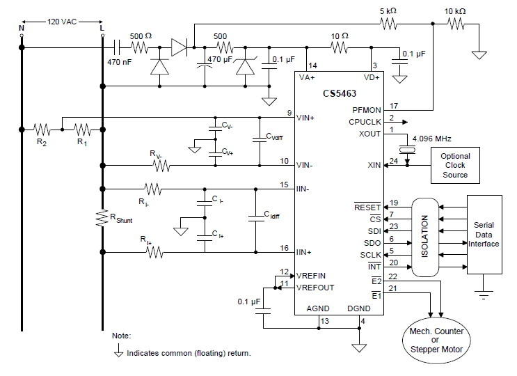

A modern way:
http://www.cirrus.com/en/products/cs5463.html
