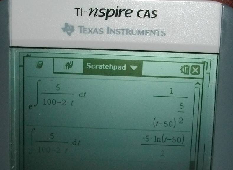

I get a different answer:
Is there another source we can check?

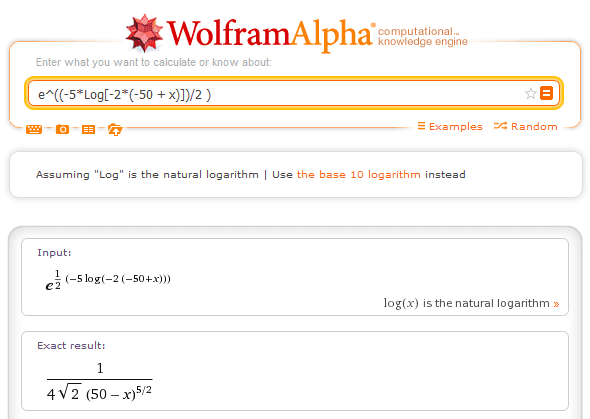

That's strange that it's giving you that answer. I checked by doing it by hand, as well as wolfram alpha and I get (-5/2)ln(50-t).
do you have a wolfram alpha link? I want to try it.
wolfram says: (-5*Log[-2*(-50 + x)])/2
That's not the answer I got, nor is it the answer you got...
