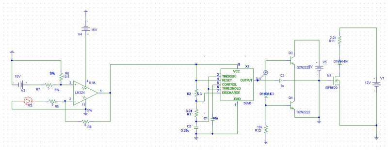

My choice of solid state Dc circuit breaker is the Mosfet, easily available( i got loads!)
i want the mosfet to interrupt the circuit to protect the load from overvoltages
This is what I've done so far, please help its not working the way i want it to.
the resistor connected to the inductor is the load i want to protect
You have breadboarded this circuit, or are you saying the simulation doesn't work?
You have managed to get the DC supply for the op-amp mixed in with the 24V for the load. Separate these. You intend operating the 324 on a single supply?
Is that really a 10 Ohm resistor in series with the FET's gate?!
I suggest that you remove the inductor and its associated zeners, etc, and the 24V supply, and concentrate on getting just the op-amp and the MOSFET working. Perhaps use a LED and a 2.2k resistor to represent the load, powering it off the 10V, so you have a visual indication of the MOSFET switching correctly. Only when that is working and the voltages all tally with your designed values, should you bring in the load and its associated power supply.

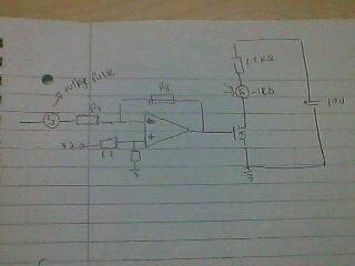

hi please could you give me a quick sketch of the type of circuit you just described in this post
10v to to power the mosfet and the opamp and the LED being there to give me an indication that my mosfet is switching.

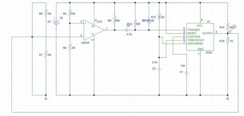

this is what I've got so far, are my connections correct.
i want the gain of my differential amplifier to be 2.
so i can decide R2 ,R1, R3 and R4 pretty easily, my question is though, is it necessary to have those resistors in place?
I think you will need those 4 resistors around the op-amp. Don't forget that the op-amp needs to be supplied with power, too.

The power supply pins are often not shown on basic schematics. V2 is not for the power supply (although you may need to connect V2 to the power supply as well, to allow the op-amp to operate off a single supply.)
Your original attachment showed power supply connections. Download that op-amp's data sheet and check that you have it correct.

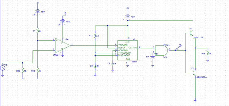

in this circuit how do i prevent the voltage at the source of my Mosfet from being distorted
i am trying to feed it back to the inverting input of my opamp but i can't do that for now because it is awfully distorted
I would have said the source is grounded. Maybe you mean the MOSFET's "top" terminal? But that's not what you want to feed back either. When the FET is ON its drain voltage is low and it likely stays low even when the 15V shows some voltage spikes. The drain voltage will never trigger overvoltage protection.
Are you really powering pin 8 of the 555 from your OP-AMP output? Is that intentional?
What is the purpose of the pair of 2N2222's?
Don't you want the MOSFET to be ON and conducting during normal operation? Then if the voltage supply (shown as 15V here) goes too high the comparator switches the MOSFET OFF and no current flows from the 15V through the LED to ground. That's how I picture it to operate.

sorry should have been more careful before i sent a circuit design
the pair of 2N2222's is actually supposed to be 1 NPN and 1 PNP transistor to give a push-pull output, this serves to source some current to the mosfet to kick start it.
the LM324 is supposed to be a LM393 but i don't have that comparator in my package.(should have stated that! sorry)
yes the output of the comparator is to be connected to pin 8 and 4, if its a comparator the output signal should be strong enough to connect it directly
this is how i see it working.
The surge at the inverting input( is going to be replaced with the feedback from the source of the mosfet) when Vin(overvoltage) > Vref the output at the comparator is low
vice-versa the output is high
when the output is high a signal is sent to the 555 timer which sends it to the mosfet
in short, this means that when the input voltage is above the Vref no signal is sent from the comparator( this config limits the current in the load=2.2K+LED )

I can't picture the MOSFET requiring a "kick start", whatever that is. Its gate draws no current, so why do you think you need a push-pull stage to drive its gate? Where did you get the idea of needing a push-pull stage here?
If the 555 sits there inoperational during normal use of the circuit, what will be the signal level at its pin 3 for driving the next stage?
I can only repeat what I said earlier. The voltage at the source of the MOSFET switch is not going to show any significant change when there is a spike on the 15V supply. Shouldn't you be sampling the 15V supply instead?

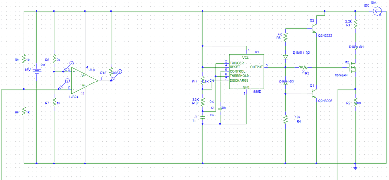

you are right, the 15V should be sampled instead. that is my reference voltage. i was confused.
the push pull should be removed as well, really don't remember why i put that in there. more confusion am guessing. This is what my current circuit looks like, its almost all good except for one thing, the feedback from the mosfet source (input voltage) is much lower than the reference voltage. How do i boost the input voltage??
also i have introduced an Ac current in the load, causing the fault current condition.
the 555 is not inoperational during normal use, my mistake if i implied such. However during normal use, the 555 would be at a low, i.e sending a low signal to the mosfet thus turning it off.
Sampling the voltage across that 100 Ohm resistor is actually sampling the load current. I doubt that is what you would ever want to do. Load current is [in general] no indicator of load voltage.
You have again got the 15V supply for the control circuit intertwined with the load supply voltage. I assume you want these to be kept separate: the source powering the load should connect only to the load, nowhere else.
the 555 is not inoperational during normal use, my mistake if i implied such. However during normal use, the 555 would be at a low, i.e sending a low signal to the mosfet thus turning it off.[/color]
Have you got this wrong, or am I misunderstanding what you are trying to achieve? Surely the FET is ON during normal operation, and it turns OFF to interrupt current to the load upon detection of abnormally high voltage?
You want to interrupt the load current for a short preset period, and then reconnect the load, is that the principle of operation? Are you sure that is going to be acceptable? What is the nature of the load are you planning to power?

At this stage, don't worry about including a LED to indicate a fault condition. That's merely a decoration which can be added in later. You are confusing me and yourself by discussing two LEDs. Well, I think you are.
In your original sketch you showed an inductor and resistor representing the load. I suggested that in the preliminary stages you should substitute a LED and its current-limiting resistor for the L-R load as a visual indicator of load current status. The LED will glow when load current is flowing because in this simplified arrangement the LED current IS the load current; the LED is the load.
The MOSFET is in series with the load. When the MOSFET conducts (i.e., is ON), current flows through the load and through the MOSFET to ground, so the load gets powered. If an over-voltage is detected, I believe you want the MOSFET to become non-conducting (i.e., turn OFF), so no current flows through the load or the MOSFET.
Why are you reluctant to indicate details of the load you are wanting to protect?

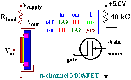

There is only 1 LED, represented by the diode in series with the 2.2kohm resistor
My issue is my if the mosfet conducts, i.e is on how does that interrupt the current flowing through the load? won't the mosfet being on, simply let the current flow through the mosfet?? there is no break in the circuit if the mosfet turns on to protect the load( at least i don't think there is)
When you want to interrupt the current, you turn the MOSFET OFF. MOSFET current stops, so does load current because the load is in series with the MOSFET.
You will probably end up connecting multiple MOSFETs in parallel to produce a switch with sufficiently high current rating. I think there should be no issues with doing so.
well my design is evidently wrong i built part of it today and i kept on burning the 100ohm resistor as well as other components.
could you please show me how to properly connect a comparator to a 555 timer, so that the comparator output triggers the timer to turn on and off.
I think i got that quite wrong, therefore everything else connected to it has been done wrongly.
1 question though: if the mosfet is off and current can't flow through it, how does that current get to the source( that is what i am using as feedback for my input)
also if the mosfet turns off when there is a fault, won't the fault just remain where the 2.2kohm+LED is?
so here i have reconnected the comparator to the 555 timer, properly i believe.
I tested it by introducing a pulse voltage at R8 and R7, introduced into the inverting feedback.
The timer and the comparator responded the way i wanted them to.
However pulse voltage won't be supplied to it when i am building it.
I want to introduce a feedback from my timer output into the inverting input of the comparator(in this package, the opamp)
What can i do to fix it?? it is just giving me a flat line and the timer doesn't seem to be triggering once i try and feed it back to the comparator.
Why would you want to?

hi, so i have finally decided on what my load should be.
A small motor.
coil 1= 100mH
coil 2= 100mH
coupling= 0.5
Does this design make more sense? had to change the whole thing based on our discussion. Now i believe the mosfet should appropriately turn off to prevent current flow.
the push pull drive the switching mosfet
however i am not getting the results i expect.
I expect to get a pulse wave from my comparator.
When the input > reference the comparator output is at a low.
I expect to get a pulse wave from my 555 timer, where when comparator output is low timer output is high. This information should now be sent into the mosfet which will switch on when the timer output is high. [ this is when the input voltage> ref voltage, i want it to switch off during this instance] so to do that i should include an inverter?
having included a NAND gate everything works just fine but 1 little glitch.
When i replace the voltage pulse with a 3K ohm load and a mosfet then feedback the output of my push pull config to the gate of the mosfet i get nothing?
am i sure this is how its done this time, because mosfet turns on when VGS>Voltage threshold. and off when VGS is less.
I used the NAND gate to inverse the timer output which was a high.
so far this is what i have
please let me know if i am doing something wrong
A small motor.
coil 1= 100mH
coil 2= 100mH
coupling= 0.5
That's a motor??
What has that reapppeared? I can't see it serves any purpose. The 555 can drive the MOSFET directly.
You could use a spare FET (plus a resistor) to form an inverter.
There are issues with a 555 monostable when the trigger has not returned to HI before the 555's pulse ends and output returns to LO. (See its data sheet). A fix for this is probably to include a differentiator between the comparator and the 555; this will produce a narrow pulse on each transition of the comparator's output. It's just a capacitor and resistor, and possibly a diode.
Oh, I see it's precisely what you had on the 555's trigger input back here:
So you just need to restore that. The 2.2μF may be bigger than is needed, try 0.1μF and see how that works out. Have a look at the waveform on pin 2 and see how healthy it looks. It should show pulses that quickly return to baseline level well before the 555 gets triggered again.
