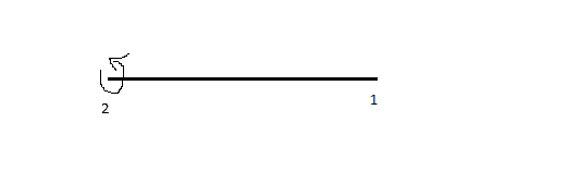

I think I'm missing something really simple here due to being out of school for a while:
In a free body diagram, if I am trying to take the sum of torques about point 1, how should I deal with an applied torque at point 2? See attached sketch

Do you mean a couple, a pair of equal and oposite forces?
The the torque is the same about any point. :wink:
