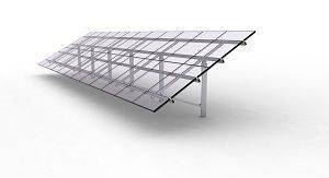

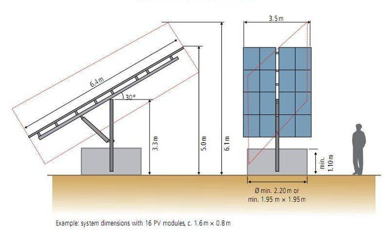

I am planning to install a Solar system of 6KW of electricity output enough for a water pump (submersible) and a small home.
I need help in designing a mounting which can hold upto 24 solar-panels (20kg each) at a height of 6 meters from the ground, and I also need to make an adjustment mechanism for 3 tilt angles to get the best light.
Can someone please guide me as to how can I design the structure, what forces to calculate, and how to relate it to strength of materials?
I have something like this in my mind:
Is wind or snow a consideration?
In general, this is a big structure to plop on top of a single pole.
It would be cheaper and stronger to support the panels near the four corners. You could still change the angle of the panel by making the support posts longer, so you could just tilt the panel up or down as needed.
US roofing standards use a 20-40 lbs/ft**2 snow load assumption, that should be ample for your panels.
Do note that solar tracking is expensive for what you get. It is usually cheaper to oversize a fixed installation, which also simplifies the maintenance requirement.
There is no snow here, but sometimes we experience wind-speed of up to 40mph. I used calculators provided on the internet to find out that with wind loads the total load of the panels will be around 11000 Newtons.
Yes, I believe so. I was planning on using 3 to 6 pillars in a line, not supports at the corners.
We cannot afford solar-tracking, but I would use just 3 tilt angles for different seasons, and would like to make a mechanism that will allow for only those 3 tilt angles.
And, the mounting will be a standalone structure.

Just be sensitive to the effect of the size difference. Your 3.5x6 meter array is big and may be near the limit of what these struts can readily handle.
