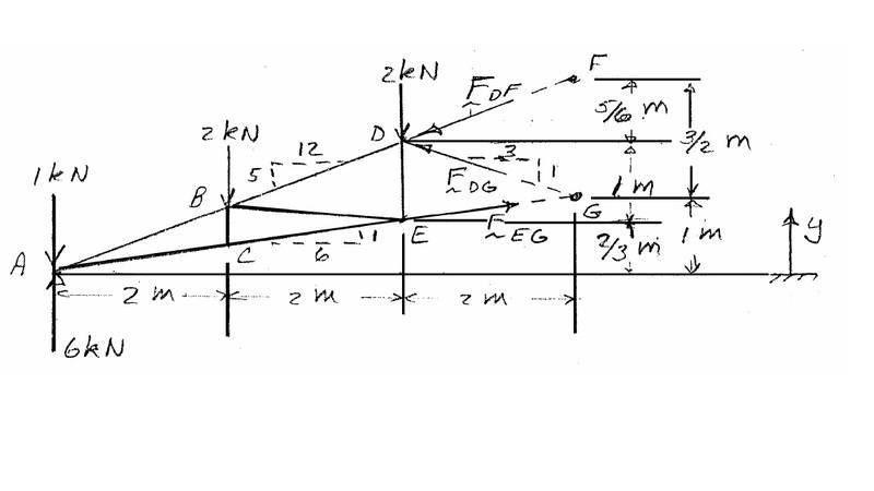

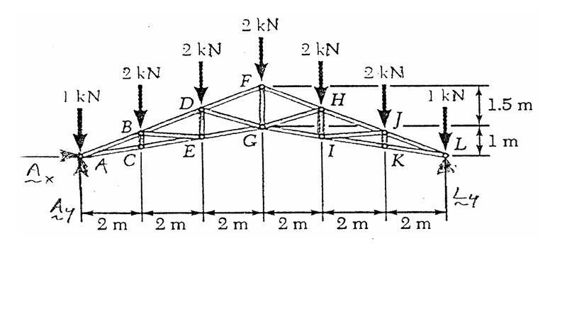

Ok, I have everything done for this problem... I just don't understand how they got some of the distances! Just look at the uploaded images...
- Where did 2/3 m come from? (The vertical distance from the support to E)
- Where did 1 m come from? (The vertical distance from E to D)
I calculated different distances, like D - E = 1.67 m using rules of 3 or proportionality.
I'm sure it's something simple but I just can't see it...
Thanks in advance

You've got to review simple proportions.
Lookit: the vertical distance from the support to E
The total vertical distance from A to G is 1 m
The vertical distance from A to E is x m.
The horizontal distance from A to G is 6 m
The horizontal distance from A to E is 4 m
Writing our proportion, x/4 = 1/6
solving, x = 4/6 = 2/3 m
All other distances can be solved in a similar fashion.
