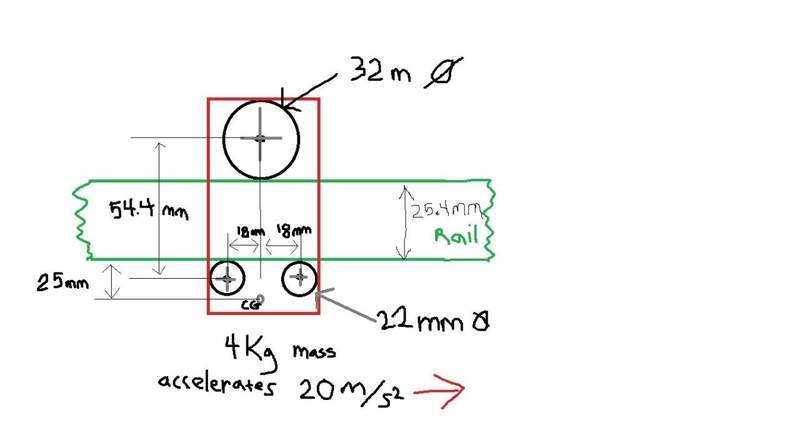

The problem involves determining the reaction forces on cam followers of different diameters when a roller cart accelerates. The context includes the mass of the cart and the specified acceleration.
  • The original poster attempts to calculate the reaction forces on the cam rollers based on the given mass and acceleration. Some participants question the application point of the force causing the acceleration and whether the calculated forces are accurate.

Cam followers are 25mm and 32mm in diameter. Mass is 4kg. Determine the reaction forces on all of the cam rollers when cart accelerates to the right at 20 m/s^2
(4kg)(20m/s^2)(.05m)/(.018m) = 222 N on small roller to the right? Is there an equal but opposite force on the large roller too?

Where is the force applied that is causing the acceleration?
assume it is applied 25mm directly below the C.G. (inline with C.G./centered between small rollers)

You suggest (4kg)(20m/s^2)(.05m)/(.018m). I think it's only half that.
List all the forces you believe will operate and write down any equations relating them that you can think of.
