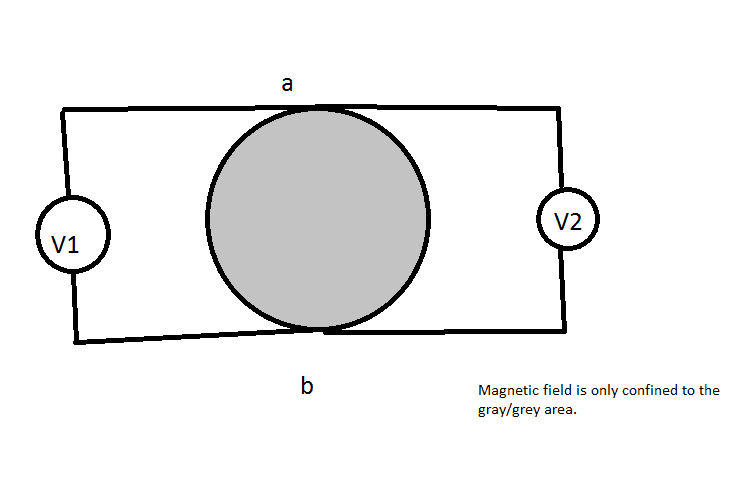

But the problem is when i put the 2 voltmeters across the diameter (which i refer to as a and b) of the circle of a uniform resistance loop, one would measure a>b, and the other would measure potential at b>a (refer to attached)
if I only use 1 voltmeter, it would seem like what potential i measure depends on how i place the voltmeter...say only V1 is used and without changing anything I just move V1 to V2's position, then I would measure V2! I don't think it explains the correct physics... Neither would it suggest what I measure if I place V1 at a position above the loop (with magnetic shielding).

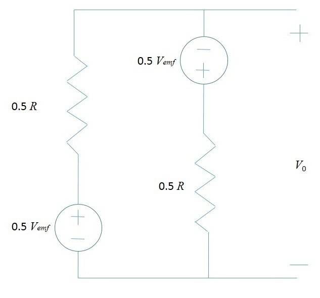

Consider the situation that you mentioned where the voltmeter's leads are attached at opposite sides of the loop. Consider this lumped parameter model. What's V0?

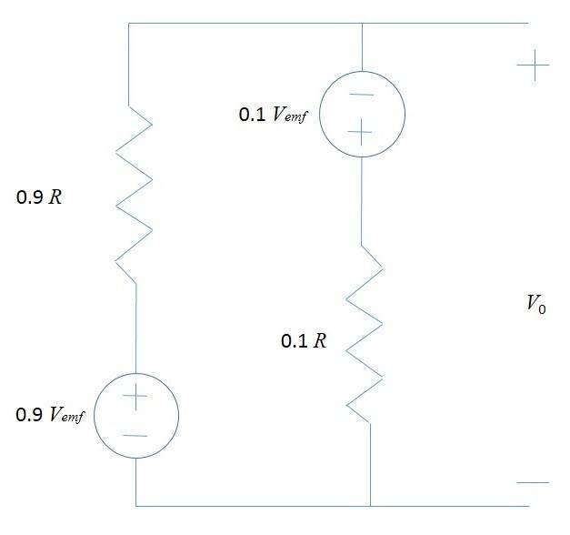

Okay, suppose that the voltmeter's leads weren't at opposite ends of the closed loop, but separated by only a small part of the arc. What's V0 in this case?

I need more guidance.
For the symmetric case, it would be similar to how the ring is imagined to be tapped with a voltmeter on opposite ends: whatever EMF gained is promptly consumed by the resistance:
Using kirchhoff's loop rule, [itex]0.5 V_{emf} - 0.5RI + 0.5 V_{emf} - 0.5RI = 0[/itex]
So... [itex]I = V_{emf}/R[/itex]
Applying Kirchhoff's loop rule again, [itex]V(+) + 0.5V_{emf} - 0.5 RI = V(-)[/itex]
Thus, [itex]V_{0} = V(+) - V(-) = -0.5 V_{emf} + 0.5 R V_{emf}/R = 0 [/itex]
But I have this nagging feeling it should be [itex]0.5V_{emf}[/itex], but can't show why.
Similar conclusion can be drawn for the asymmetrical case. [itex]V_{0}[/itex]

Correct! Very good. :approve:
I could say, "trust your math on this one." But maybe I can help out a little more intuitively with one last set of exercises below.
Yes, that is correct too. :approve:

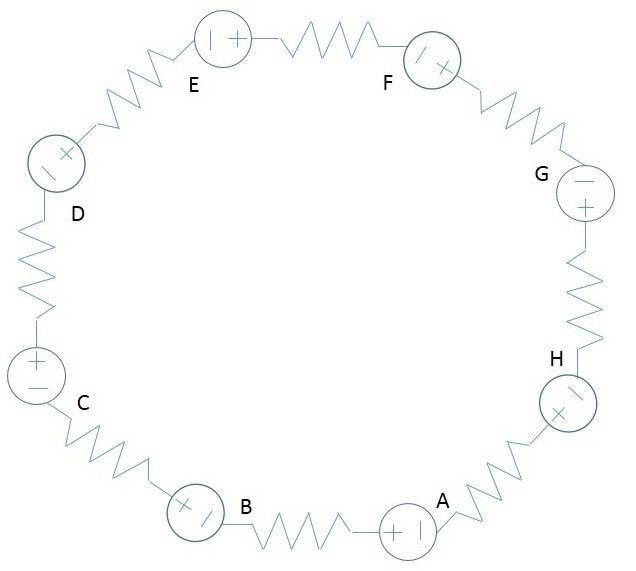

Following the same general idea that you just did above, consider the following figure. Assume all voltage sources shown have a potential difference of 0.125Vemf each, and each resister has a resistance of 0.125R.
  • What's the electrical potential of point B relative to point A?
  • What about point C relative to point A?
  • D relative to A?
  • And all the way up to point H relative to point A?
(Hint: This is the same sort of thing you just did with the last couple of figures. Given what you already know from the last set of exercises, you are allowed to do this one in your head if you wish.)

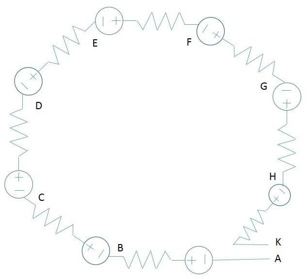

Now let's get a little crazy with all this. :smile: Let's break the loop open. This time, as shown in the figure below, we no longer have a closed circuit.
  • Okay, now what's the electrical potential of point B relative to point A?
  • D relative to A?
  • And all the way up to point K relative to point A? :wink:

(Hint: This is the same sort of thing you just did with the last couple of figures.)
Zero at every point designated.
  • 0.125Vemf
  • 0.250Vemf
  • 0.325Vemf
  • 1.00Vemf
Correct! :approve:
  • 0.125Vemf
  • 0.250Vemf
  • 0.325Vemf
  • 1.00Vemf
Correct again. :approve:
I've lost sight of how this is related to the loop in changing magnetic field...
Well, if you have a completely* closed conducting loop in a changing magnetic field, current can and will be induced in that loop. But if you apply a voltmeter to any two points of that loop** the potential difference is always zero.
*(if all of the loop is within the changing magnetic field, and the loop has uniform resistance.)
**(let's assume the voltmeter's leads don't significantly poke inside the magnetic field too.)
We've used 8 resistors and 8 voltages sources here in our lumped parameter model. If we were to take this to its limit and model a realistic closed loop in a changing magnetic field, we would use and infinite number of infinitesimal voltage sources alternating with an infinite number of infinitesimally small resistors. The combined emf of the voltages sources is canceled out by the combined IR drop of the resistors. Current does flow, even though all points on the loop have identical electrical potential.
This is equivalent to your hypothesis labeled "Three" in your original post.

Well, the argument is so far good, but it doesn't seem to reconcile with what my lecturer says, which is the basic motivation for starting this topic. I swallow the potential difference is always zero at any two points better, but there seems to be something else missing...Consider the following diagram,
Letting resistance be uniform...
"The electric field associated with a time-varying magnetic field is not conservertive:
[itex]\oint_{C}\vec{E}(\vec{r},t).d\vec{r} = -\frac{d}{dt}\int_{S}\vec{B}(\vec{r},t) . d\vec{A}[/itex]
The magnetic field is increasing, so by faraday's law/len's law the induced EMF and thus current flows clockwise.
[itex]V_{1} = \frac{1}{2}*\frac{d\Phi_{B}}{dt}[/itex] (ignoring the -sign for now, 1/2 for half the resistance of loop)
V1 and V2 have the same size but:
V1 = Va - Vb > 0 (like how the field points from lower potential to higher potential in an battery)
V2 = Vb - Va > 0
