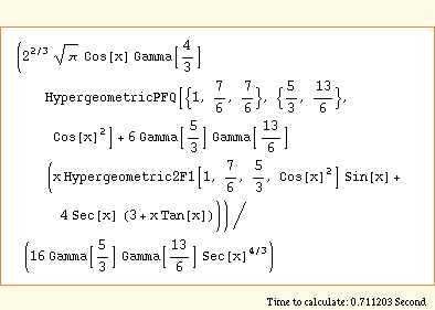

The function of the type:
[tex]\int {(x^2 + 1)^{5/2}}x dx[/tex]
This is simple to integrate but the trigonometric function:
[tex]\int 3/5{(\sec x)}^{5/3}x dx[/tex] is already a problem.
The first gives:
[tex]\int {(x^2 + 1)^{5/2}}x dx = \int {u}^{5/2}1/2 du = 1/2 \int u^{5/2} du = 1/2 ({2u^{7/2}/7 + C) = 1/7{(x^2 + 1)}^{7/2} + C[/tex]
what are you trying to find out?
Okay.There's no possible connection between the 2 integrals and the second is not an elliptical one.
There's the result for
[tex]\int x (\sec x)^{\frac{5}{3}} \ dx[/tex]
Daniel.
Thanks for the solution. I see that the 2nd is a generalized hypergeometric function. Is [tex]\int ( cos x )^{3/2} dx[/tex] also hypergeometric?
Nope,that's elliptic.I think I've posted the solution in another thrread *looks for the solution*.Nope i confused it with another one.
There it is
[tex]\int \cos^{3/2}x \ dx[/tex]
is equal to
Daniel.
