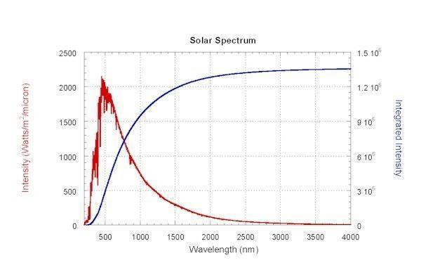

ONE EXPERIMENT: If you paint a magnifying lense with such a coating, would you be able to burn with it when you focuse a sun light? Or, on the other hand - if you would paint a concave miror could you start a fire with it? (as I understand almost 50% of sunlight is in infrared spectrum)
The solar spectrum is shown below (AM0). You can see that with a filter such as silver oxide you would loose ~75 % of the total energy available (e.g. you're not going to be toasting bugs with that magnifying glass).
