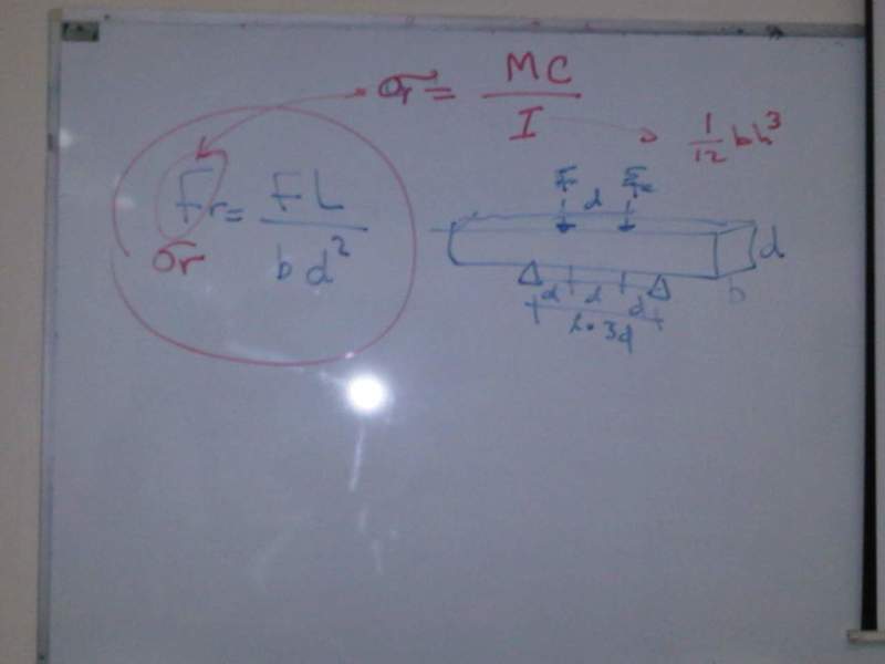

How can I prove this equation:
it is attached in a photo.

Which equation? There are at least three, and some use the same variables.
the equation which is circled
