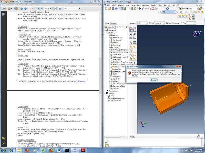

I am attempting to mesh this part using "hex" elements but I always receive an error. Am I supposed to partition the part? If so how do I do that?

i think you should divide the model into three simpler parts so that the programe can mesh with Hex automatically.
