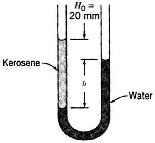

The manometer illustrated in Fig. Q2 contains water and kerosene (specific
gravity of 0.82) as indicated. With both ends of the U-tube open the height
H0 =20 mm.
(i) Determine the height, h , when both ends of the tube are open. [4]
(ii) Determine the new value of H0 when a gauge pressure of 98 Pa is
applied to the right end of the U-tube. [6]
2. The attempt at a solution
I can do part (a), getting an answer of 91.1mm.
However, I am stuck on part (b).. I assume I cannot keep h constant and see the variation in Ho with the added pressure?
I am unsure how to work out the two unknowns h and Ho with only the one equation.

In part (i), you determined h, so, from the figure, you now know that total length of the kerosene column. This doesn't change in part (ii).
Are you sure h doesn't change? In my lecturers solutions it does change.. I don't really understand his solutions but maybe you can explain?
I have attached his solution.
I didn't say h doesn't change. I said that the total length of the kerosene column doesn't change.
Chet
Oh I see, sorry I didn't read that carefully enough. Thank you I get it now! :)
