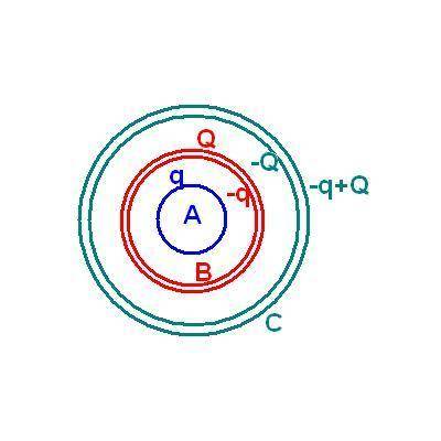

There are three concentric thin spherical shells A,B and C of radii a,b and c respectively. The shells A and C are given charges q and -q respectively and the shell B is earthed. Find the charges appearing on the surfaces of B and C.

It is correct that the q charge of shell A induces -q charge on the inner surface of shell B. But B is grounded, and can suck up charges from the earth. You do not know what charge is on the outer surface of B. Let it be Q. Then -Q charge is on the inner surface of C - what is on the outer surface? And then, what is the potential of C? The potential has to be zero at infinity, and also on the shell B.

Remember, the electric field emerge from charges and end in charges (or infinity).
Assume a<b<c, shell A is inside, C is outside and B is in between.
Shell A has charge q, that entirely appears on its surface. That means q/ε electric field lines between shells A and B, according to Gauss' Law. These end on the surface charges on the inner surface of B, which means -q surface charge there.
As B is grounded, it can have any charge. Assume that the surface charge on the outer surface is Q. Gauss' Law says that that the number of the electric field lines between B and C is Q/ε. These must end on the negative charges on the inner surface of C: The surface charge on the inner surface is -Q. The total charge of C is -q, the charge is shared among the inner and outer surfaces, so there is Q-q surface charge outside.
The potential is zero in infinity and on shell B. You need to write up the potential difference between C and infinity and between C and B , in terms of q and Q and the radii b and c. That gives two expressions for the potential of C. Equating them, you get the charge Q.
ehild
