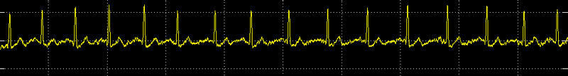

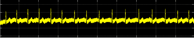

Hi guys
i built an ECG system(preamplifier and filters), but i faced a problem in the filters:
the standard of ECG filters is 0.1 Hz cuttoff frequency for highpass filter and 100 Hz for lowpass filter
but i only obtain a good ECG signal when i make the cuttoff frequency of highpass filter 1 Hz and lowpass of cutoff frequency 80 Hz(8 order)
is my ECG filters correct(1 Hz and 80 Hz)?
or the filters cuttoff frequencies should be as the ECG filters standard?
i ask this question because i am writing a research paper.
When the cutoff frequencies were at 0.1 and 100 Hz, how is the waveform distorted? If you can post schematics and waveform captures we can better analyze the problem.
ok ,this the ECG signal when the cutoff frequency of lowpass filter is 100 Hz
and this the ECG signal when the cutoff frequency of lowpass filter is 80 Hz
The fact that the noise is reduced so dramatically by such a small shift in cutoff frequency is impressive and likely due to your use of an 8 order filter. First I would consider sources of 120 Hz such as the rectified power supply. Of course it may not be 120 Hz noise and it would help to expand the display to see if you can determine the frequency.

i use digital filter(matlab) , my hardwere is only preamplifier.
Can you use Matlab to calculate the FFT of your waveform? That will give you a good idea what coefficients you should use for your filters.

this is the FFT of ECG signal
it very clear that the noise 100 Hz com from power line harmonic
