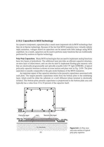

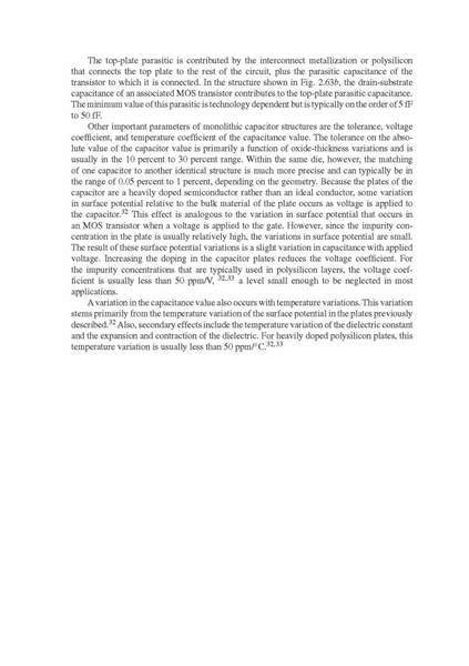

ZapperZ said:
No, it doesn't. I need to see the context of that description.
Zz.
Which description, the figure or the quote from my first post?
In any case, I attached pictures of the section from which I extracted the quote for my first post.

Read carefully. Notice that it says variation in surface potential with APPLIED field! This means that you can vary such potential as you vary the applied field! The applied field effectively changes the vacuum level, and thus, even with a fixed Fermi level, you can vary the surface potential!

The applied field increases the vacuum level, which in turn increases the difference between the vacuum level and the Fermi level. In this particular case, does the surface potential represent the same thing that the work function would?

Careful. You can increase or decrease the difference between those two energy levels by changing the polarity of the applied field.
The surface potential becomes the work function for a metal, assuming you know the work function of the "probe metal", i.e. you know the work function of one of the electrode. In a semiconductor, this difference between the vacuum level and the fermi level may also be called the work function, but this is not the same as the photoemission threshold as in metals. This is because the photoemission threshold for a semiconductor is the electron affinity plus the energy gap.

So back to the section on Poly-Poly Capacitors. If we apply a potential difference, positive for the top plate and grounded on the bottom plate (i.e. the E field is pointing down from top to bottom), would the surface potential of the top plate increase, while the surface potential of the bottom plate remain the same?
