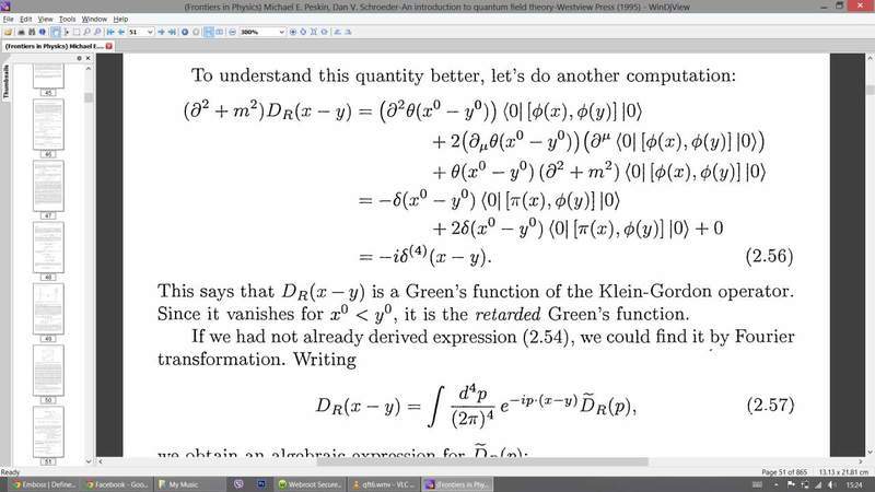

Again, from the Peskin and Schroeder's book, I can't quite see how this computation goes:
See file attached
The thing I don't get is how the term with [itex](\partial^{2}+m^{2})\langle 0| [\phi(x),\phi(y)] | 0 \rangle[/itex] vanishes, and also why they only get a [itex]\langle 0 | [\pi(x),\phi(y)] | 0 \rangle[/itex] from the [itex]\partial_{t}\langle 0 | [\phi(x),\phi(y)] | 0 \rangle[/itex] and not also a [itex]\langle 0 | [\phi(x),\pi(y)] | 0 \rangle[/itex]
Me neither. Peskin/Schroeder is pretty unclear concerning propagators and its analytic properties.
It is because of the free field eqn. (∂2+m2)[itex]\phi[/itex]=0,the last term vanishes.Note also that ∂μ will act only on operators whose argument is x,not y.Also the first term will involve a by part to get the result.Rest is just simple calculation based on commutator relation and some property of step function.
Likes 1 person
That was the key I was missing, probably missed due to writting it so abstractly :P. Thanks!
That's not writing it "abstractly" but just bad notation. If there are more than one space-time argument involved, you always should write explicitly wrt. which one you take partial derivatives.
