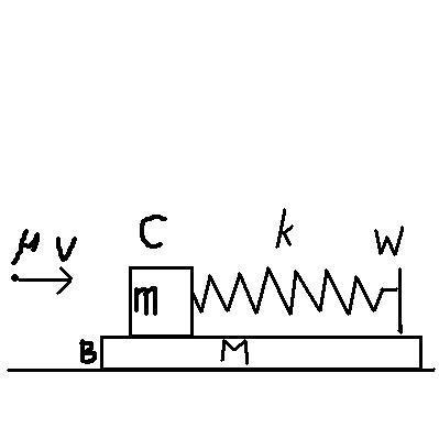

have a look at the diagram
A physical system consists of wood block B and mass M. B is at rest on frictionless horizontal table. A small vertical wall W is place near one of the ends of B. The wall is fastened to B.A spring with spring constant k is attached to the wall and is connected tp a block C. of mass m.
No friction between C and B. A bullet of mass mu [itex]\mu[/itex] is shot is shot into block C. The velocity v is parallel to the table. The spring does not bend.
Assume that the bullet is stopped in such a short time taht t is negligible. The spring mass and the wall mas are neglected
a) find the maximum compression d of the spring, in terms of v, k, M , m and [itex]\mu[/itex]
bullet goes into the block inelastically so
[tex]\mu v = (\mu + m) v_{f}[/tex]
and [tex]v_{f} = \frac{\mu v}{\mu + m}[/tex]
this vf (kinetic energy) is converted to spring energy
[tex]\frac{1}{2} (\mu + m) (\frac{\mu v}{\mu + m})^2 = \frac{1}{2} kx^2[/tex]
and thus [tex]x = \mu v \sqrt{\frac{1}{k(\mu + m)}}[/tex]
this is assuming that [tex]x = \Delta L + D[/tex]
and D is converted to the energy that makes this thing go forward
so [tex]\frac{1}{2} k D^2 = \frac{1}{2} ( \mu + m + M ) v_{f}^2[/tex]
[tex]D = v_{f} \sqrt{\frac{\mu + m + M}{k}}[/tex]
now here's the dilemma, what is v?? i cannot find D without using some unknown velocity
how would i use the conservation of momentum here?
