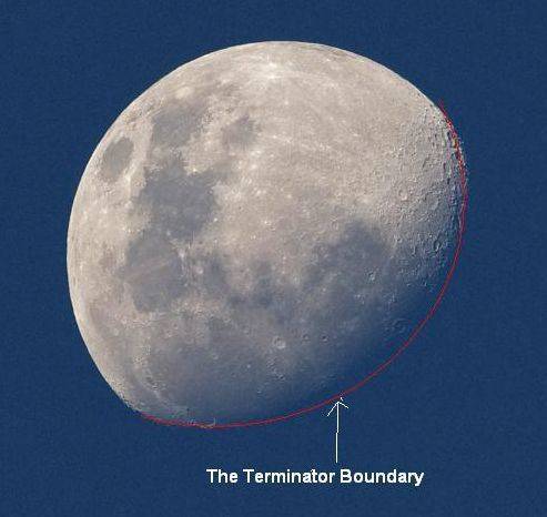

from one of my many Lunar photos
Lunar Terminator
the line separating the day and night areas on the lunar surface as seen from earth
another way to think of this, is its the sunrise line (Sunset line - see below) if you were on the lunar surface
Viewed from earth, you don't see a terminator line at New Moon, as the face of the Moon that we would normally see is in darkness. As the Moon goes through its orbit around the earth, we see the Moon becoming more and more illuminated by the Sun as sunrise advances across the Moons surface. Then when Full Moon is reached, we again no longer see the terminator line.
From Full Moon back to New Moon, we again observe the terminator line moving across the face of the Moon. This time tho, its the advancing sunset.
cheers
Dave
