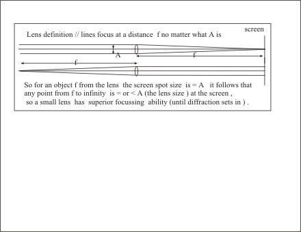

To Aviator
as Integral said this is geometric optics ( that means straight line ray tracing )
To understand this you need to understand what a simple lens does .
Take a point object emmitting light towards a simple lens , on the far side those rays will come to an almost point also but at a given distance . But only at ONE distance .
That is the object to lens distance changes the point at which the rays focus .
