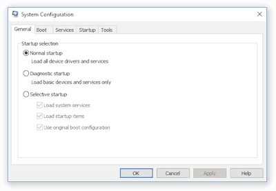

Follow the steps and get into safemode. Once there, let's take a look at your startup routine. Start>msconfig
It will look like this

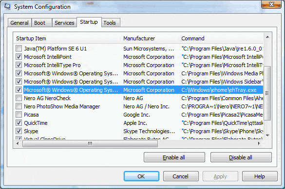

Click on the startup tab. This will show you a list of all the programs that are going to start when your computer turns on. I suggest clicking on Disable All. The reason is that none of those programs are usually critical for the system to work.
Then apply the changes and reboot the system and enter windows normally. Try to see if the iLivid program starts showing advertisements again. If they do not, then one of the programs in that list was the problem. Then you simply have to go through that list (or post a list of all the items in this thread) and manually delete the files causing the issue.
Normally, the names are descriptive enough so that you will know what the program is. If you do not, then scroll right and take a look at what the entry is under the Command column. Google the file name and it will give you a good indication of what program is and then you can decide if you need it or not.

What operating system are you running? XP, 7 or 8? I can give you step by step instructions to open the msconfig tool.
Medgirl314
Medgirl314 is offline
#5
Dec16-13, 11:23 AM
P: 555
Windows 8. I found directions that said to restart the computer and push F8 and I could get to the msconfig tool from there, but for some reason it's not working. Thank you!

Try following the steps here
http://pcsupport.about.com/od/tipstr...msysconfig.htm
On step 4, select Network: Starts Safe Mode with Networking.

Great! In safe mode. So what am I selecting now? I went to msconfig and selected "disable all" before I went into safe mode, but I don't know if I should have because I thought the whole point of this was to select that option.
Routaran
Routaran is offline
#13
Dec16-13, 01:54 PM
P: 271
Yes, I would start by disabling all items under Startup. Make sure you do not make any changes under services, this can really break your computer.
Once this is done, go back under the boot tab and UNCHECK the safemode option. Apply the changes and restart your computer. This will instruct windows to NOT start any extra programs when you log into your account in windows. There's a good chance that whatever is generating the popup advertisements will get turned off too.
Then just use your computer like you normally do and check to see if you still get the advertisements. If you do not, then the program creating the advertisements was one of the programs in that start up list. Then you have to go through that list line by line and try to identify which one is the problem program.

Thanks! I'll have to keep that in mind. I'm not sure what program it is right now because I've gone through the list and almost all the programs are the ones from Microsoft. Have you heard of Alps Electric Co. as a manufacturer for programs? Looks off to me. I looked it up and only found an electric company having nothing to do with my computer.

Alps does touchpad mice. Is this a notebook computer?
Look under the command column, it will give you a full path and a filename. That's your best indicator.

Thanks! I looked up the file name, and some people are saying it's malware. It does say DellT though, like it's a touchpad. I'm not sure of the definition of a notebook computer. It is a laptop. Do you know any tricks to confirm(or not) that it is a problem?
