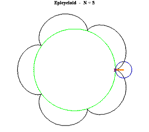

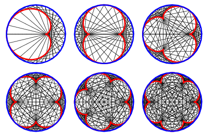

Suppose I wanted to cut an epicycloid with K cusps (cusps = petals if you think of them as flowers).
http://mathworld.wolfram.com/Epicycloid.html

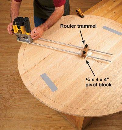

Well, to start simple, suppose we only wanted to cut a circular piece of wood. I would make a trammel with a pin extending through my trammel and the piece of wood I'm cutting. On the opposite end of my trammel, I would place my router at a fix distance from the pin, and then I would either rotate the trammel OR rotate the piece of wood I'm cutting
If we want to cut an ellipse, we modify the trammel in the style of the "Trammel of Archimedes"--------------------------------
