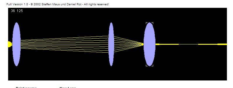

It seems like it should be easy to use two lenses to 1: focus light into a small point then 2: use a stronger lens past the focal point to keep the beams fairly parallel. Experimentally, I have not been able to achieve these results.
I have an LED flashlight which can project a fairly tight beam with high culmination. (shadows from objects in the beam are crisp at a considerable distance.
I place a lens in front of it with a focal length of 10cm and then another lens with a focal length of 1cm, 1cm behind the pinpoint of light. I would expect to be able to keep the beam of light fairly culminated but in a much tighter compressed beam. However my results are very diffuse, and when adjusted to project an actual image, the image size is larger than the original.
I'm just curious if it is possible to compress sunlight into a pinpoint, and then keep it pinpoint size by using a concave lens to focus the beam at infinity. I know sunlight isn't perfectly parallel, but it seems fairly parallel as shadows preserve their crispness for many meters.
I would think you could make a psuedo-laser "deathray" capable of igniting things for at least 30 feet?

The issue is that the Sun is far from a "point source". Instead of having a narrow beam, you'll have a number of collimated beams that spread out from each other. Actually, this is exactly what an eyepiece does. When focused correctly an eyepiece will cause exiting beams of light to be collimated in preparation for being focused by your eye.

In actuality, focusing the beam actually makes it harder to focus it further, because you've introduced more beam divergence. (The more a beam is focused the more the beam diverges).

The problem is probably that your flashlight is not collimated. For a collimated source, this ought to be quite easy.

Well, define "pinpoint". The size of an actual pin is cake for a good optical system. But if you mean "arbitrarily small", you have have problems because there the ray-optic approximation ceases to apply. You have to apply a wave-optic approximation instead, which always has some extraneous beam divergence by virtue of wave diffraction.

Use a spatial filter- focus the light onto a (small) pinhole. The pinhole, if small enough (10 microns or so), acts as a point source.

The general principle that makes your death ray impossible is that the area-solid angle product of an optical system cannot increase in a passive system. With sunlight you get almost collimated rays of the same area as your input aperture. Your flashlight is probably configured so the output is similar. To focus these down you increase the solid angle. To do this you have 'traded' a small spread in angle for a small spread in space. Entendue is a commonly used term for this.
As Andy Resnick says a pinhole will allow superior collimating but will cost you light.
