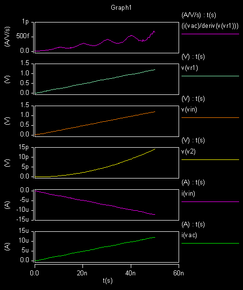

Sorry for the delay. Now I can see the transient response. But the curve doesn't seem right I guess.
The code is:
Vin vin 0 DC 0 pulse=(0 1.2 0 50n 0 0 0 0 51n)
Vac vin vr1 AC 0 SIN (0 10m 100MEG)
R1 vr1 v2 100k
M1 0 v2 0 0 nmos l=1 w=10
.TRAN 1p 50n
.end
The response is as follows:
The easiest way to do this is with a transient analysis and a pulse so your input should be fine. Remember in the time domain that I = C dV/dT or C = I / (dV/dT). So divide the measured current with the voltage slope and that is your capacitance. You should do it with a rising and falling pulse and average the value you calculate.
