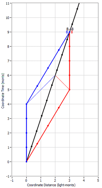

I don't think they or anybody else should be baffled that a symmetrical situation should be, well, symmetrical. There's no need to propose any device as you suggest, they already have everything they need to establish Time Dilation.
First, let's suppose that they set their calendar/clocks to zero as they passed each other (just to make our calculations simpler). Then let's just suppose that as they are sending and receiving their messages, they each see the other ones signals coming in at one-half the rate that they are each sending them. At the end of the first month ship A will send a message to ship B saying that it is the end of A's first month. Ship B will get this message at the end of his second month so he will send a message back to A saying that at B's date/time of 2 months he got A's message sent at A's date/time of one month. Ship A will get this message at his date/time of 4 months.
So what does ship A do with this information? He applies Einstein's second postulate that his first signal took the same amount of time to get to B as B's response took to get back to him. Since the total time from sending to receiving was 3 months (4-1), he divides that time by 2 and gets 1.5 months as the time after he sent his signal, or 2.5 months as the time on his calendar/clock that ship B received the signal. Furthermore, ship A also establishes the distance away that ship B was as how far light travels in 1.5 months which is simply 1.5 light-months.
Since Time Dilation is the ratio of Coordinate Time (the same as the time on a stationary clock) to the time on a moving clock, ship A has just established that ship B's calendar/clock is dilated by a factor of 2.5/2 or 1.25.
Also, ship A establishes that since ship B was 1.5 light-months away at ship A's time of 2.5 months, then ship B is traveling away from ship A at 1.5/2.5 or 0.6c while ship A was stationary.
It should be clear that ship B could have also done the same thing and established that it was at rest while ship A was traveling away in the opposite direction at 0.6 c and that it was ship A's calendar/clock that was time dilated by a factor of 1.25.

You may have noted that the example that I used was not the example you described because you specified a speed of 0.8c and mine turned out to be 0.6c. But if you understood my explanation, I'd like you to work through another one where they each see the other ship's calendar/clock running at one third of there own and see if that turns out to be your example at 0.8c. Can you do that or do you need more help?

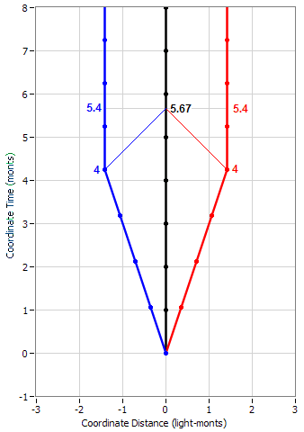

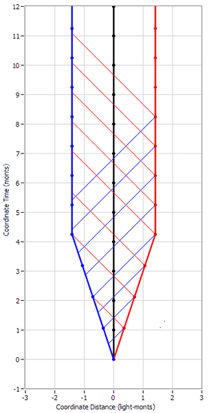

You said that they were communicating before they passed each other so they could have easily agreed to send the same kind of signals and done the same kind of calculations that they did afterwards. The only difference is that they will each see the other's signals coming in at twice the rate of their own signals going out, instead of half the rate which is true after they pass.
Unfortunately, it gets a little hard to conceptualize how this works but let's pretend that while they are approaching, they simply keep track of the times on their own calendar/clocks and then they make an adjustment to accommodate setting their calendar/clocks to zero when they pass. This makes all their times have negative values prior to them passing.
So 4 months prior to passing (we'll call it -4 months), ship A sends a message to ship B who gets it at -2 months and sends a message back which ship A gets at -1 month. Ship A does similar calculations as described in my previous post and comes up with the same Time Dilation of 1.25.
Does this make sense to you?

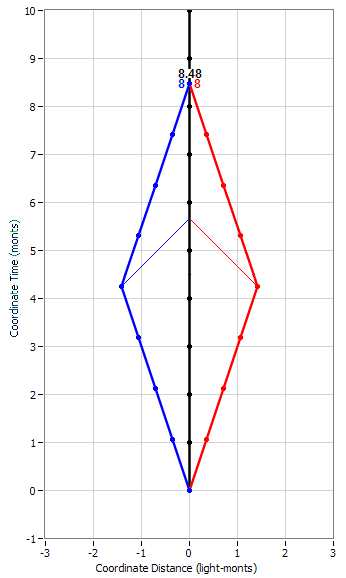

1) Imagine A and B start off from the same point together with clocks set to zero. They head off in opposite directions, traveling at the same speed away (away from the point of origin). When their respect clocks reach 4 months, the stop so they are at rest rst the origin and hence each other.
When they stop I ask them to send their clock time back to me at the point of origin. I notice I receive their information on clock times both at the same time and that both their clocks say the same amount of time has lapsed (4 Months) However the time past for me will be longer.
But I can concluded that as 4 months have elapsed on both A and B's clocks during that time, and as they were the same age when the started off, they will be the same age now. I don't need to bring them back together to know that. (As I understand it) Although I could bring them back at the same speed and would see they have aged the same.

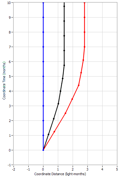

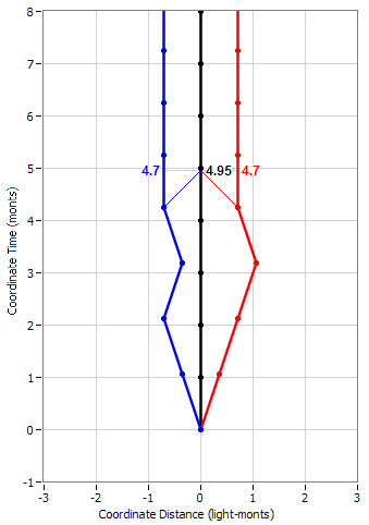

2) Now imagine a similar situation where A and B set off from the same point with their clocks set to zero. But this time A takes 'W' trajectory away from the point of origin and B takes a 'Z' trajectory. I arrange the trip so the total distance traveled in the W and Z trajectories is 4 light months AND that they travel at the same speed. I have also worked out that relative to me the end point of each trajectory is 2 light months (or some other equal distance) away from me at the point of origin.
I tell them to set off on their journeys and at the end of their journeys (4 months on their clocks) stop so they are at rest wrt to me at the point of origin and send back their clock times.
Now this is the part I get confused over. As A and B had both traveled the same distance in their respective frame and finish the same distance away from me at the point of origin, will I receive their signals at the same time as with the first experiment above?
Or would I receive them at different times because their journeys were not symmetrical and thus I would get the 'W' journey first as it had the most changes in direction?
Also, in the first experiment there seems to be a contradiction as during the travel time both A and B could say that the other's clock was running slower but when they finished their journey, the are both the same age.

Simultaneity is the answer. A key part of SR is the fact that which events an observer regards as simultaneous will change if his rest frame changes. While A and B are in relative motion, A regards B's clocks as running slow, and says for example that "now", B is younger than A, celebrating his 25th birthday. When they come to relative rest, A's definition of "now" has changed, and A says that B is now the same age as him, age 30.
In your rest frame, this is true. This is not true in other frames. For instance, in a frame where you are moving to the left (in the direction of A) the distance that the light from A travels is less than the distance that the light from B travels. Therefore, the fact that they arrived at you at the same time implies that A is younger than B. This makes sense because in this frame A traveled faster than B.
The problem with comparing the ages of distant objects is not that it cannot be done. Clearly it can. The problem is just that the result depends on the reference frame used for the comparison.

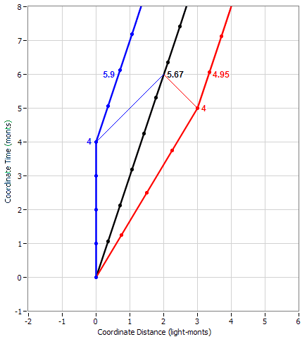

This is the bit that is confusing me.
As has been pointed out by others, what you are calling "now" is only true in your rest Inertial Reference Frame (IRF) which we can illustrate in an example where the two travelers went away at 0.333c. Here is a spacetime diagram showing your scenario. You are shown as the thick black line, A is shown as the thick blue line and B is the thick red line:
Note that your clock has advanced to 5.67 months when you receive the two messages from A and B that they have reached the 4-month mark for them to stop. And by the time you get their messages, their clocks have advanced to 5.4 months.
We can use the Lorentz Transformation process to see what this scenario looks like in A's rest frame during his "travel time":
Note that you still receive the messages at your time of 5.67 months, even though it took different amounts of time for the messages to get to you and A and B are not the same age when this happens.
Yes, if you bring them back at the same speed, they will continue to age at the same rate. Here is a diagram showing this:
You have aged more than the travelers (8.48 months) but they have aged the same (8 months).
But now this is true in all other IRF's. Here's the same one we did before:

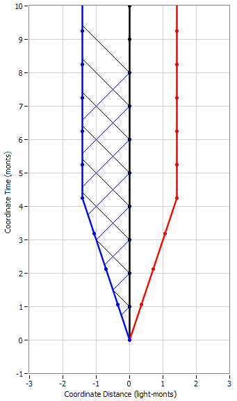

Yes, here is a diagram to depict what I think you described:
Symmetry doesn't matter. Remember in post #10 I said that direction doesn't matter? The only thing that matters is speed according to an IRF. As long as both travelers are always going at the same speed, then they will be subject to the same Time Dilation and end up with the same aging when they rejoin you.
If you apply the technique I described for you in post #8, sending messages back and forth, then A can make a non-inertial rest frame for himself and it will show you how even though A determines that B's clock was running slower than his at the beginning, it can still catch up at the end. To make an accurate diagram, A will have to send out continual messages and get continual responses back from B but I will only show those where B's clock increments one-month intervals. We will also have A communicating with you. Here's the signals going between A and B:
And here's the signals going between A and you:
Remember what A does with the information:
This allows A to construct this diagram:
As you can see, even though both you and B are Time Dilated at the beginning, you eventually surpass A while B just catches up.
I understand now that direction doesn't matter. But I thought change in direction did? Due to acceleration? So although the distance and speed covered by the 'W' path and the 'Z' path is the same, as the 'W' path has changed direction more than the 'Z' path doesn't that mean that the two will age differently when the come to rest?
Although as both come to rest the same distance from the origin where the set their clocks, then I guess the total acceleration (change in direction) would be the same as the angles would have to add up the same?
Does that make sense?
rede96 said:
Thanks for the space time diagrams, they really help make it clear.
You're welcome. I'm glad they helped.
No, only the speed according to an IRF matters to the Time Dilation which means the rate that a clock ticks. Acceleration only matters if it results in a speed change, not a direction change.
