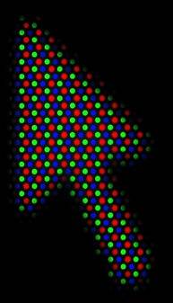

The old analog CRT computer monitors, being able to adjust beam parameters can handle a wide variety of resolutions, and although there is a mask with a fixed number of "holes", the beam can partially cross and/or start/stop between mask hole boundaries, allowing for what at the time were high resolutions, like 2048 x 1536, or 1920 x 1440 (both 4:3 ratios). Sony made a "wide" screen CRT that could display 1920x1080 (16:9 ratio). Example image of a "white" arrow from a CRT screen. Note the partially painted "holes" at the edges. If you stand far enough back you'll see a white arrow.
