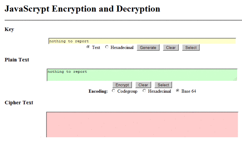

http://www.fourmilab.ch/javascrypt/
The local secure storage of your own passwords is a quite different scenario to passing regular traffic over an open channel.
