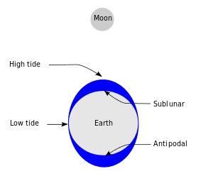

You seem to be ignoring the fact that, using your model of tidally exposed/unexposed land, that high tide happens one one side of the earth, and you forget the other side is low tide (simplified take on this). Only a small contiguous fraction of the ocean is at any full high tide at anyone time, the same idea holds for low tide.
Also, tides are cyclic neap tides -> spring tides -> neap tides. So only at the height of a spring tide can the most land area be exposed by low tide on two "sides" of the Earth (actually a band), while least land area is exposed at high tide (two bulges: sublunar and antipodal). Is this what you are driving at in your question?
Plus "time" has nothing in particular to do with the biggest spring tide - just the position of the Earth relative to sun and moon, plus the moon at apogee. A new moon at lunar apogee and Earth apogee (closest to the sun) would be the strongest possible spring tide.
Maybe what I said is not relevant to what you are asking, so please try again... and I just do not get it.
This explains things with pictures. http://en.wikipedia.org/wiki/Tide
Is that true? I thought the other side was on high tide too?
Anyway, are you suggesting that the tides preserve area? Because this is clearly not true. Consider an Earth with an ocean of 10 km deep everywhere with only one mountain that barely sticks out of the ocean at low tide. Then as the tides change, the entire Earth is covered with water. So in this earth, the area of land covered by water does change during the day. So I see no reason as to why the area of land does not change during the day in this earth.
No, I cited the same picture. High tides are two bulges. I thought I conveyed that idea, my bad if not.

That isn't true. There is no such thing as a tidal bulge. That was Newton's idea, and it is one of the few places where Newton was wrong. It's Laplace's dynamic theory of the tides that provides a much more accurate picture of how the tides work.
At any given time of day, one can always find a spot somewhere along the coast of the North Sea where it's high tide, and some other spot where it's low tide. The same applies to New Zealand, Patagonia, and Hudson Bay.
At any given time of day, one can always find a spot somewhere along the coast of the North Sea where it's high tide, and some other spot where it's low tide. The same applies to New Zealand and Patagonia.
Then why do you see Newton's theory everywhere? Including wikipedia and in classrooms where children are actually taught that? This is very much a surprise for me.

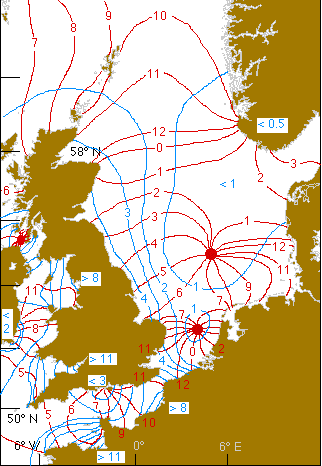

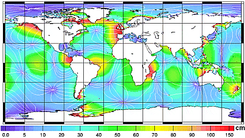

There are curved white lines emanating from the the centers of the dark blue areas in this image. Those centers are "amphidromic points", places where the response to the roughly twice daily component of the tidal forcing function due to the Moon is zero. Those curved white lines are cotidal lines, places where the phase delay to the M2 tidal component are equal. If the M2 tidal component was the only thing that caused the tides, high and low tide would occur at the same time along points on one of those cotidal lines. The response to other driving frequencies (there are a number of them) will be rather different, but it's the twice daily response to the Moon, that governs the tides at most places on the Earth covered by water.
Here's the M2 tidal response in the North Sea:
The red points in this image are the amphidromic points. There are two in the North Sea and (at least in this image) one just on-shore in Norway (others have that point just off-shore). The cotidal lines are in red, spaced by about one hour. The blue curves represent tidal responses. From this image one can see that its always high tide somewhere in the North Sea.Explaining the tides becomes rather ad hoc at the local level. If you look for a tidal station (e.g., Key West, Florida), you'll inevitably see harmonic constituents to a number of different aspects of the overall tidal forcing function. For example, at Key West, Florida, the lunar semi-diurnal (M2) tidal coefficient is the dominant cause of the tides, but there are several other frequencies that come into play. Understanding this as a physicist is easy: Just think of it in terms of Fourier analysis.With regard to your original question, snorkack, I suspect it was based on the idea that the equilibrium tidal bulge is what governs the tides.
