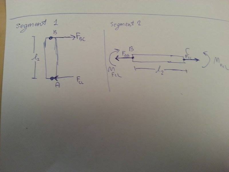

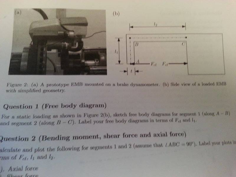

The second question has something to do with a question I found on a textbook in regards to drawing a free body diagram. I'm a newbie at this and I'm not certain whether this is the right way to draw it. Can anyone give me a head up. (The question and my work out is in attach files)

2) Your free body diagram for AB is not in equilibrium. The FBD for BC is looks right.

For question 2, I thought the one that has a mistake in is segment 2. Is there any other force/moment involves in segment 1? I thought the only force acting on it will be Fcl and Fbc, could there be a bending moment caused by Fcl in segnment A?
In order for segment 1 to be in equilibrium you have to sum all the forces in both directions to zero and to sum the moments to zero. So you are missing something.
