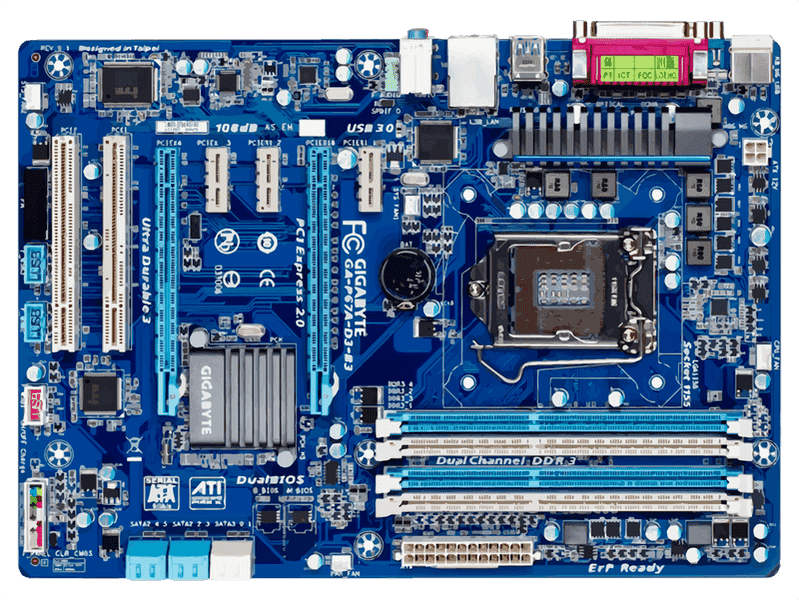

I have an old computer that I haven't used in a few years, when I last turned it on I thought that the graphics card had gone bad because all the monitor showed was green lines. last week I put a new graphics card in it and now there is no picture at all. I retired the old one and there is no picture from it either. Any ideas?

No beeps at all, but I can hear the hdd spinning up so it is doing something. I tried putting a new graphics card in and there is still no picture so I am guessing it is the motherboard.

If two different graphics cards didn't work, the other option is the monitor, or the video cable. It's possible that a modern low-cost monitor can't handle the low screen resolution or slow refresh rate from an old video card.

Is the video card plugged into a brown slot (AGP), a white slot (PCI), or some other color (PCI-E)?
Have you tried pulling all the ram sticks to see if you can get a beeping response form the BIOS?
Does the motherboard have onboard video?
it is plugged into a green PCI-E, I also tried plugging it into the yellow PCI-E it still did not work. I have not tried running it without ram yet and sadly there is no onboard video.
can you please provide the exact make and model of the motherboard and the video card? Knowing exactly what hardware you're dealing with might be helpful.

The motherboard here is a GA-p67A-D3-B3
You may already know this and if so please just accept it as a reminder and reinforcement. If you want others to help you, it helps if you provide as much specific information as possible. Some motherboards have built in diagnostics with LCD readouts, for example. Some motherboards do not have an onboard beep speaker and expect an external one in the case to be connected. Make sure you have a beep speaker connected, whether integral or external.
In general though, and if you prefer to work it out yourself, remember that your main techniques are "Pare Down" and "Substitution". It also helps to google for a Tech Manual for your specific brand/model. It may also help to "Clear CMOS" especially if you suspect it has become corrupted (unusual, but not impossible) or if the battery which powers it has become depleted or will no longer accept a recharge.
On very old mobos, prior to PCIe, the BIOS had a section called Boot Block, which accommodated only a PS/2 keyboard, a floppy, and an ISA or PCI video card for the purpose of reflashing a bad CMOS/BIOS. I haven't kept up with how this has evolved now that floppies and ISA are Hen's Teeth and PCI slots next in line. The point is there are tools but they vary by brand and model, so please post some specifics or use them yourself to seek what you need.
I will post specifics tonight when I get home, I am sorry if I seem a bit vague with my descriptions. I haven't worked on computers in a few years and I have forgotten most of what I knew. Thank you all for your help.
@iwant2beoz - I hope I didn't come across as harsh as that was not my intent at all. I actually want to help. It's just that I (and anyone else here) have our "hands tied" until we know more. If you can't find the brand and model after scouring both sides of the mobo for a silkscreened name or an adhesive tag, a picture might help.
@enorbet, don't worry you didn't come across as harsh at all. Here is what I know about the hardware. The motherboard is a gigabyte, not sure the model. The first video card is a nvidia GeForce 9800gt, the second video card is an evga e-geforce gt. If you think the model of the motherboard will help I can pull it out and try to find it. Also if you think pictures would help then I can upload them as well

So here's the updated recommendations:
1) Remove the ram and attempt to boot (it won't) to ascertain if you have a speaker connected that is beeping error codes and/or to see if there are any LED or LCD readouts that flash codes. If there are no beeps or flashes then the CMOS battery is dead or too weak to work, as noted in the above video B.Elliot provided.
2) If there are none, signifying bad battery, replace it. If this is difficult sometimes leaving it powered up for a few hours, even though nothing seems to be happening, will recharge it. AFAIK all mobos use a 3.3v CMOS and battery to power them, so these are interchangeable on the vast majority of mobos, so substitution may be a possibility.
This is the first step because Beep Codes do not require any external hardware to the base mobo - no cpu,gpu, ram, etc. The beeps are like Morse Code in that (a bit unfortunately for repair guys) each manufacturer creates a code database for specific series of CMOS/BIOS and these point to what is not working. That's why when, for example, the ram is removed, you should get a coded sequence telling us exactly that.
Once the beep codes are available, re install the ram. power up and now you should get a different sequence assuming no graphics card is installed. Then install the graphics card and cross all your fingers and maybe wave a rubber chicken over the system and chant "Oh Gods of the PC Subconscious, breathe life into this humble servant so it may toil for it's Master", ... or at least that's what I do when I'm feeling spunky :)
All kidding aside, unless some serious damage has occurred (and the fact that it displayed "green lines" <at least something> leads me to believe this is unlikely) the system should now display and function properly once CMOS/BIOS settings have been set properly.
The rubber chicken worked! I got the bloody thing to boot up:) the battery was dead, I don't know why I didnt think of checking that first. thank you guys very much:)
