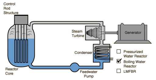

Almost 60% of these reactors are pressurized water reactors (PWRs), pressurized water serves as a moderator and coolant. The fuel, ceramic uranium dioxide, is encased in long zirconium alloy tubes.
http://hyperphysics.phy-astr.gsu.edu/hbase/nucene/imgnuk/pwr.gif
The second most common type of reactor is the boiling-water reactor (BWR). Currently more than 90 of these are operating throughout the world. In BWRs, water passes over the reactor core to act as moderator and coolant, and steam passes directly to the turbine. The disadvantage of this is that any fuel leak might make the water radioactive and that radioactivity would reach the turbine and the rest of the loop. A typical operating pressure for such reactors is about 70 atmospheres at which pressure the water boils at about 285?C. This operating temperature gives a Carnot efficiency of only 42% with a practical operating efficiency of around 32%, somewhat less than the PWR.
PWRs and BWRs are known as light-water reactors. The 33 CANDU (Canada deuterium-uranium) pressurized water reactors currently in operation in Canada, on the other hand, employ heavy water (D2O) as a moderator and coolant. The reactors use natural uranium (0.7% U-235) dioxide as a fuel rather than enriched UO2.
