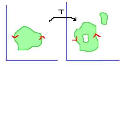

On this subject, here's a question I had always wondered about. Suppose we have a certain area in [itex]\mathbb{R}^2[/itex] and a linear map from [itex]\mathbb{R}^2[/itex] to [itex]\mathbb{R}^2[/itex]. We want to find the corresponding area after applying the linear transformation on each point of the original area. To solve such a problem, the textbook I have simply finds the corresponding [I]contour[/I] and then conclude that the corresponding area lies inside that contour. But what assures us that this is so? That, for instance, the following is not possible? (see figure)

quasar 987, that picture cannot occur for a linear isomorphism, since an isomorphism is also a continuous homeomorphism so cannot change the "connectivity" of the space, e.g. cannot change the fundamental group, or the number of pieces the complement breaks into.
the more general formula for area change munder possibly non linear maps uses the change of variables formula for several variable, integrals, and it says that the area of f(U), equals the integral over U of the function whose value at each point p of U is the determinant of the jacobian matrix of partials of f.
here we must asume f is a differentiable isomorphism, and orientation preserving, or else we must take the absolute value of the determinants.
in the special case that f is itself linear, this says that the area of f(U), equals the area of U multiplied by the determinant of f.
