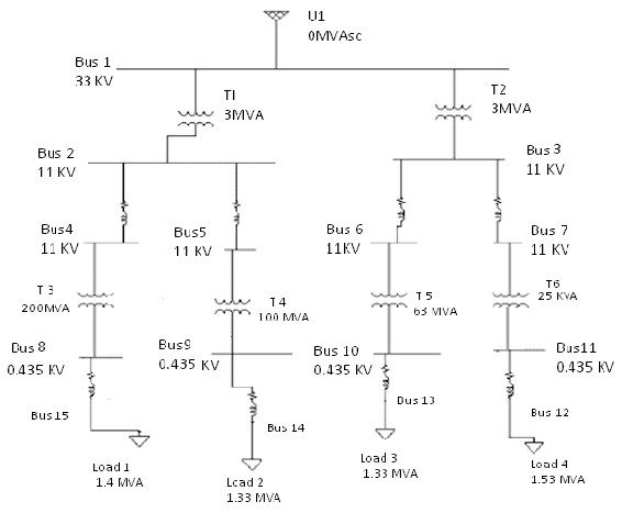

A one-line diagram:

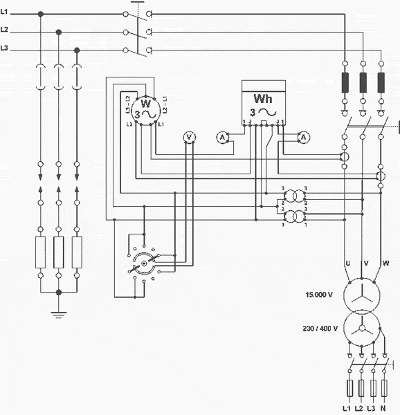

A three-line diagram:

We also use the words "one line" or "single line".
Single lines are typically used for overall power distribution like in factory substations...or a single line to describe say 100 or more substations in a factory.
Instead of using three lines, they just use one line to represent three phase power. Makes sense when you have multiple loads to keep track of on one single page or drawing.
In the drawing above, three line makes more sense because they are showing details of how to wire it.
Single lines are more of an overall view to the electrician or plant engineer.
