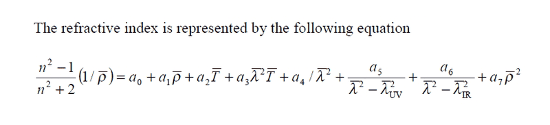

I found the equation for refractive index below :

No, the refractive index will be very nearly 1. If the index 1 specifies the standard state and the index 2 the actual state you are interested in then:
##(n_2-1)/(n_1-1)=(p_2T_1)/(p_1T_2)##
[itex](n2−1)/(n1−1)=(p2/T1)/(p1T2/)[/itex]

kinogram said:
it doesn't quite add up to 1.
I don't see why it should. Seriously, I gave you a complete formula simply enough to calculate your index of refraction. Solving for n2 should be no problem for someone who wants to do an engineering project with hydrogen at 2.7 K.
Likes 1 person
Of course, I was only responding to your previous reply
I assumed you meant that the refractive index should be very nearly 1
in order to achieve a target refractive index, we first reduce the pressure at a constant temperature
until we reach the target, then we reduce the temperature to T2,
which increases the refractive index so we compensate by reducing the pressure again - using the equation
remaining at T2, and we end up with the target refractive index and temperature.
simpleYour equation is exactly what I needed.. Thanks!
