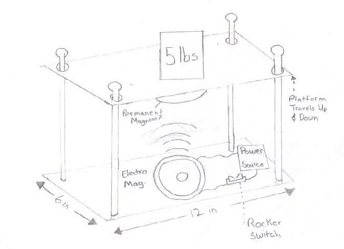

Hi Everyone, I hope this is ok to post in this section this is my first time on here. I recently was watching a show on maglev trains (I know this is not new technology but I found it really interesting). I love to tinker with little projects in my shop and was wanting to build a gadget to lift using an electromagnet. This is what I had in mind and was hoping for some help to tell me if my thinking is way off or not.
From what Ive researched an electromagnet will repel a permanent magnet. I would have two platforms connected on rails to keep them centered. When the electromagnet is energized it would repel the permanent magnet attached to the top platform, thus lifting any weight on top (Picture Below).
Thanks any help/suggestions/corrections would be appreciated.

You will also need some way to work out the force between the two magnets.
http://en.wikipedia.org/wiki/Force_between_magnets
... though I don't know what sort of permanent magnets you have access to.
Don't forget to include the weight of the plate and the permanent magnet with the load.
Your electromagnet and PSU in the sketch seem optimistically small for your load - but you'll find that out.
You'll also want something to hold the plate horizontal or it may twist and jam the guides in the holes.
Consider using a potentiometer too - to vary the magnetic field strength.

Simon Bridge
#6
Aug8-14, 10:13 PM
Homework
Sci Advisor
HW Helper
Thanks
Simon Bridge's Avatar
P: 13,124
Quote Quote by stanleysmd View Post
Greetings, Mr((?Dr) Bridge,
"Simon" is fine :)
I believe some 'maglev' systems use the principle of induced fields to generate the opposing magnetic field to lift the vehicle off the track.
This is correct - either magnets on the train lifting against an aluminium track (Germany) or magnets on the track pushing against the train (Japan).
http://www.jrtr.net/jrtr25/f58_tec2.html
I used to have a maglev demo that was a transformer coil with a cut iron core - it would levitate an aluminium plate with a hole in the middle (for the iron core to pass through) and ran off mains. The AC meant that the plate bounced a lot.
This is more sophisticated:
https://www.youtube.com/watch?v=SlUd...04786E6D905252
The spinning disk approach:
https://www.youtube.com/watch?v=dw73...05252&index=11
